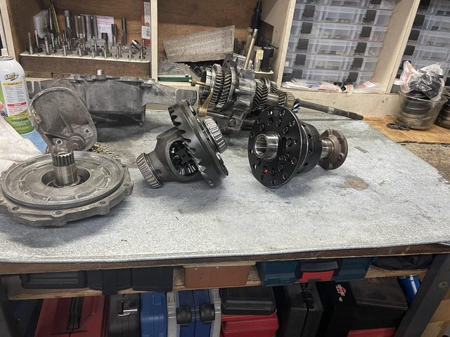

Turning to the transmission, it was completely rebuilt (and a Wavetrac LSD installed).
(IMG:http://www.914world.com/bbs2/uploads_offsite/i.imgur.com-21443-1699733007.1.jpg)

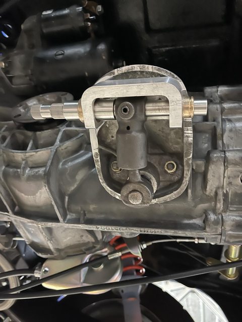

I was keen to use the Tangerine Racing short shift kit that takes out the slop in the rear side shifter - I may eventually add a front shifter kit like the Wevo or JWest.
(IMG:http://www.914world.com/bbs2/uploads_offsite/i.imgur.com-21443-1699733008.2.jpg)

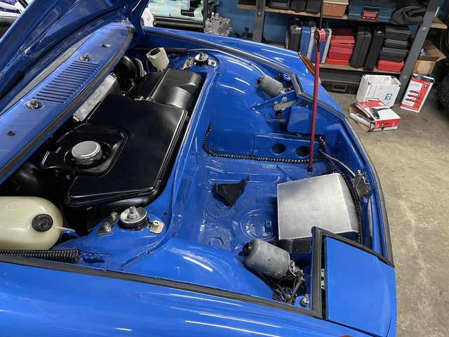

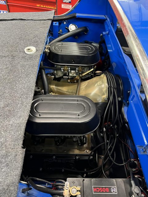

No expense spared in getting it to look factory.

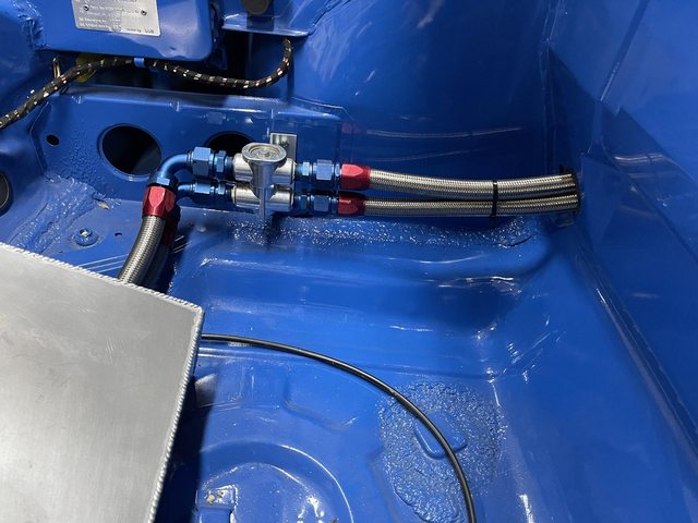

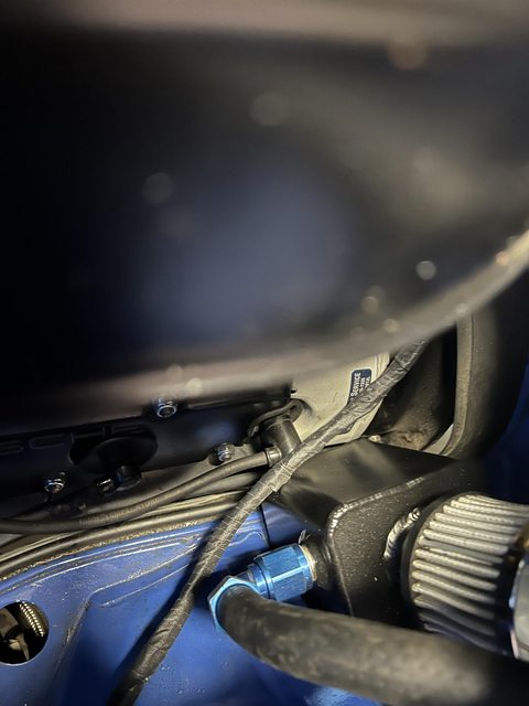

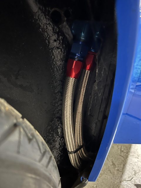

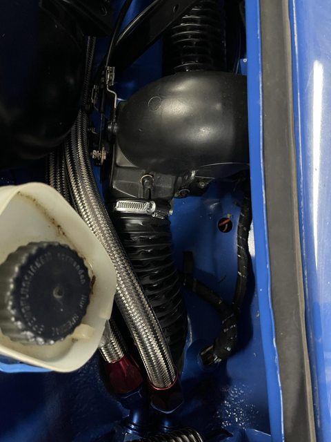

Oil lines were finished to the back, and sourced a nice catch can mounted in the lower fender well (inside the engine bay) that was powder coated.
(IMG:http://www.914world.com/bbs2/uploads_offsite/i.imgur.com-21443-1699733008.5.jpg)

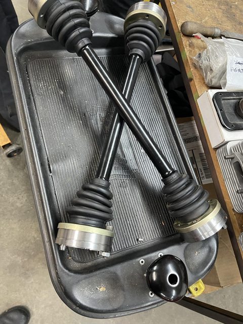

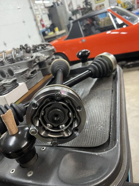

Axles rebuilt with stronger CV joints

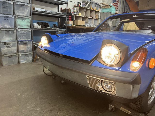

For headlights, I went with a pair of these Holley LED's. The build quality is amazing, and the light emulates vintage soft yellow glow, but they throw a nice beam.
(IMG:http://www.914world.com/bbs2/uploads_offsite/i.imgur.com-21443-1699736105.1.jpg)
