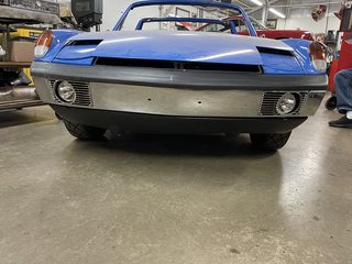

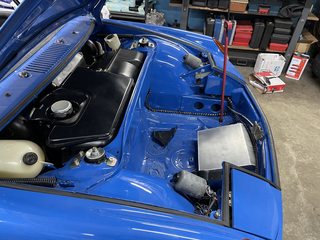

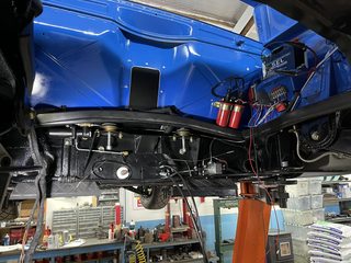

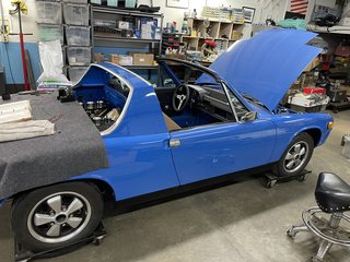

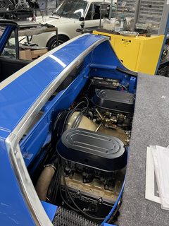

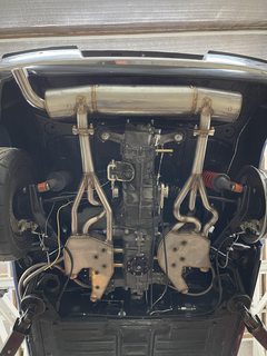

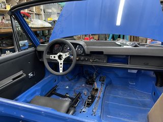

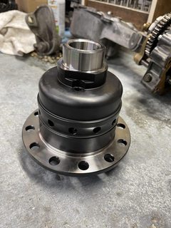

Long time since I’ve upgraded the thread. Motor is in the car and transmission rebuilt with a Wavetrac LSD and tangerine racing shift rod kit. Oil lines complete, and the focus is now turning to finishing the interior. (IMG:http://www.914world.com/bbs2/uploads_offsite/i.imgur.com-21443-1642314674.1.jpg) (IMG:http://www.914world.com/bbs2/uploads_offsite/i.imgur.com-21443-1642314675.2.jpg) (IMG:http://www.914world.com/bbs2/uploads_offsite/i.imgur.com-21443-1642314675.3.jpg) (IMG:http://www.914world.com/bbs2/uploads_offsite/i.imgur.com-21443-1642314675.4.jpg) (IMG:http://www.914world.com/bbs2/uploads_offsite/i.imgur.com-21443-1642314675.5.jpg) Note Ben’s heat exchangers and muffler (IMG:http://www.914world.com/bbs2/uploads_offsite/i.imgur.com-21443-1642314676.6.jpg) (IMG:http://www.914world.com/bbs2/uploads_offsite/i.imgur.com-21443-1642314676.7.jpg) (IMG:http://www.914world.com/bbs2/uploads_offsite/i.imgur.com-21443-1642314676.8.jpg) (IMG:http://www.914world.com/bbs2/uploads_offsite/i.imgur.com-21443-1642314676.9.jpg) WOW so awesome, its a car that would be at the top of anyones list to own for sure!! I totally agree about your assesement that this is the embodiement of what a 914-6 RS may have looked like or become if they had been able to continue to produce a /6 version of an RS car. 6 years of meticulous work and patience has paid off! Thanks for sharing |

davehg Turning to the transmission, it was completely reb... Nov 11 2023, 02:03 PM
davehg For the interior, I struggled on whether to go com... Nov 11 2023, 02:22 PM
