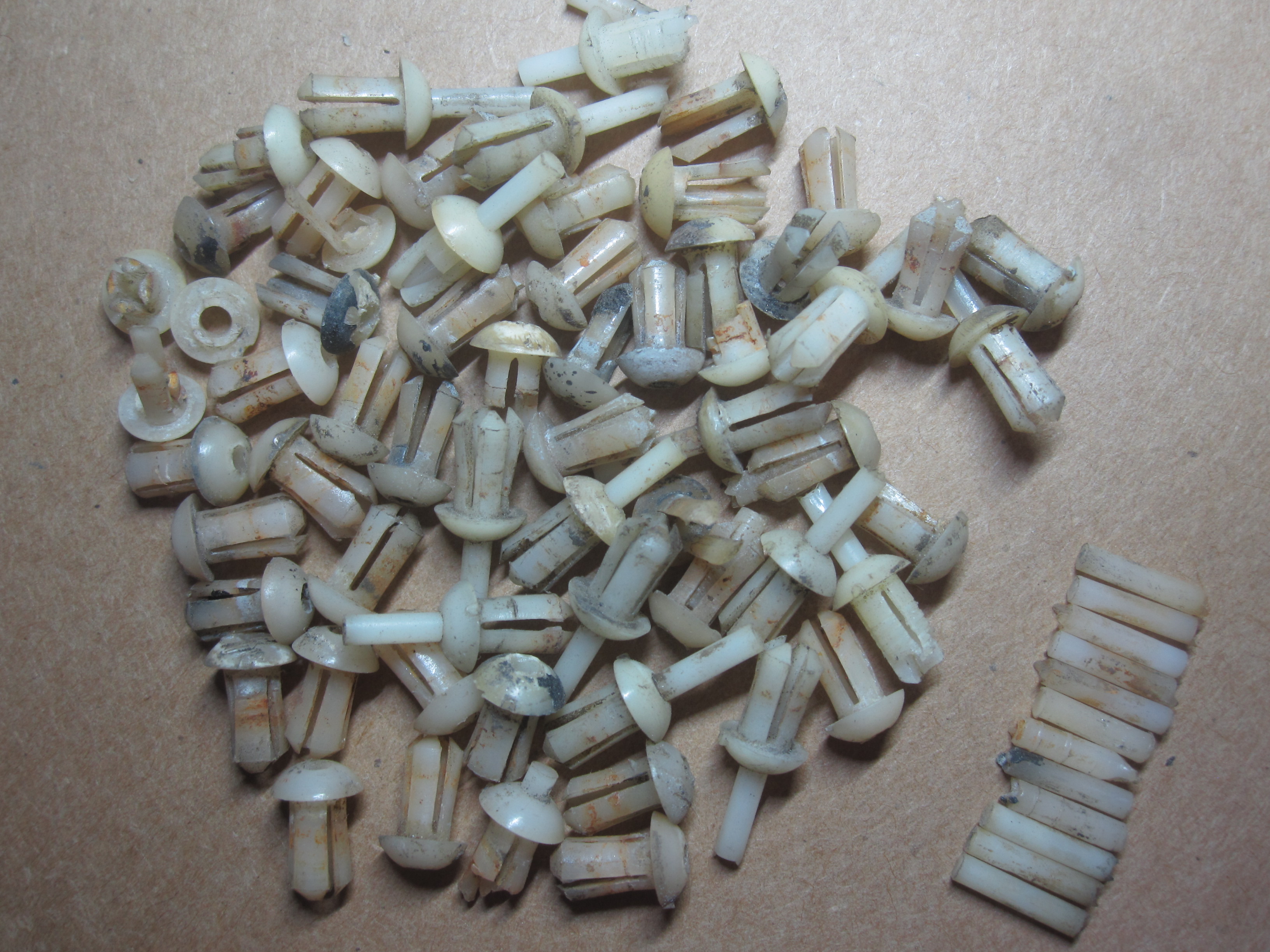

QUOTE(TonyA @ Dec 12 2023, 01:44 PM) *
What color should they be. Clear plastic or black?
Picture for color refrence only.
Sourced from early cars for years.
Not clear, not white either.
Black came '73 ?
