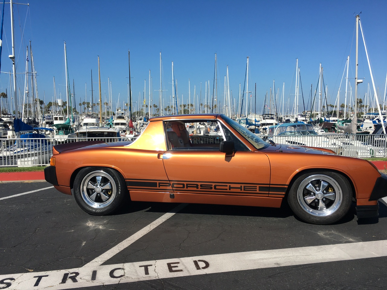

Get that VIN ? ![]() ![]() ![]() ![]() ![]() ![]() ![]() ![]() ![]() ![]() Group: Members Posts: 10,062 Joined: 1-May 03 From: Sunset Beach, CA Member No.: 643 Region Association: Southern California
6 x16s
Attached thumbnail(s) |
