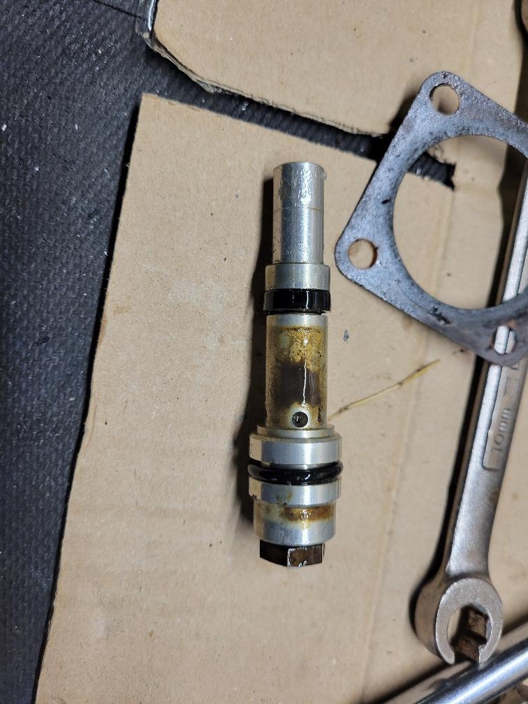

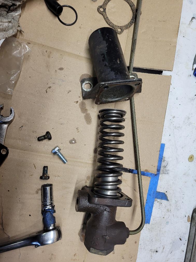

I just rebuilt mine with the PMB kit. Access with engine in and on jack stands leaves a fair bit to be desired.
Even after having bled my brake 3 times this summer, there was still crap in the regulator even as lines bled perfectly clear. Part of it likely was moisture given some of the small areas of pitting on the plunger.
(IMG:http://www.914world.com/bbs2/uploads_offsite/i.imgur.com-14731-1710450236.1.jpg)
(IMG:http://www.914world.com/bbs2/uploads_offsite/i.imgur.com-14731-1710450237.2.jpg)
It is amazing how tight the scraper seal is. It was a major PITA to install. We'll see if any pedal pressure changes in a few weeks when it's back on the road.
