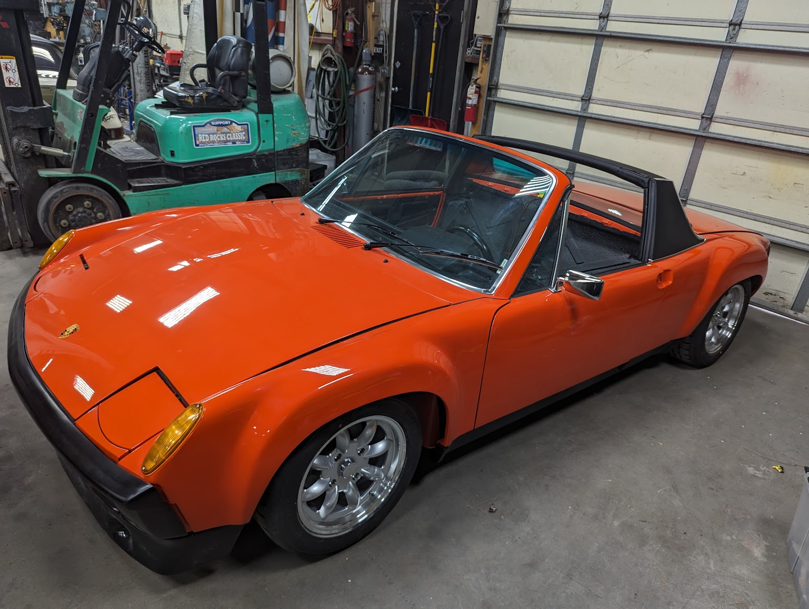

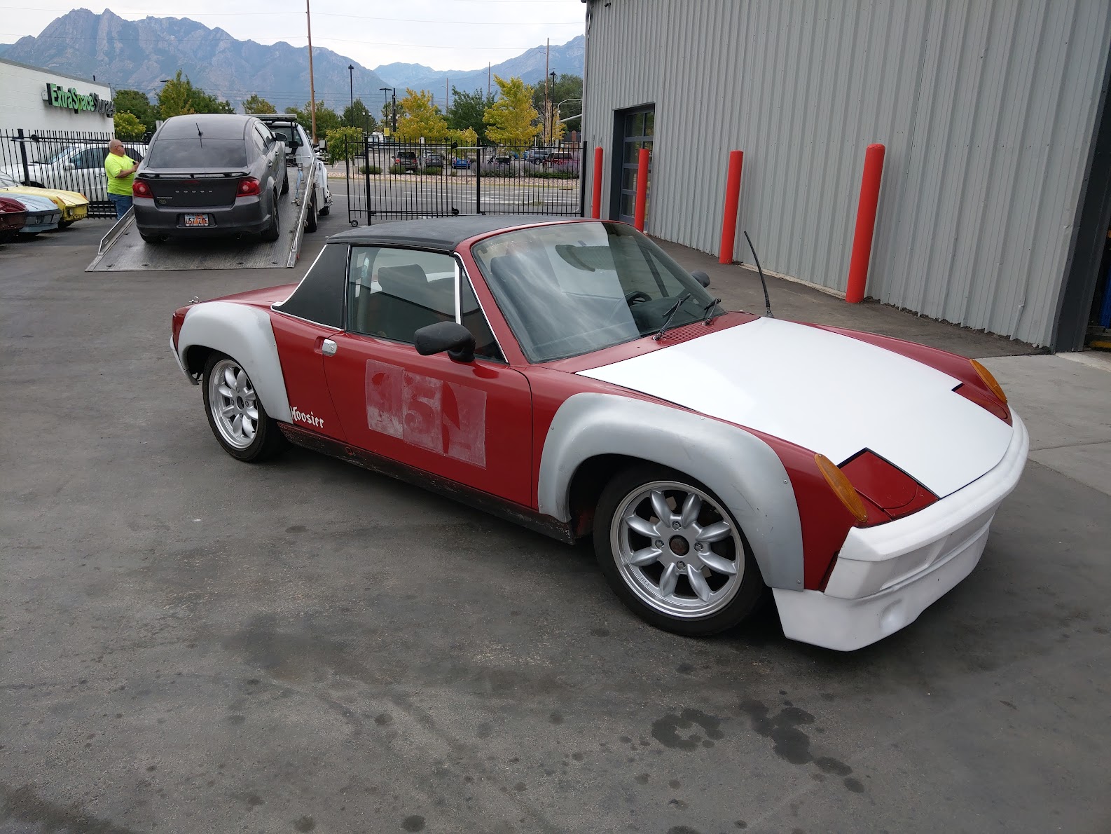

It was going to be installed on this:
And now its going on this
(Appropriately, back to its original Tangerine color)
