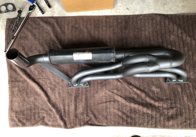

Bought my teener with three exhaust systems. Previous owner installed stainless heat exchangers (thank you) and installed a stock replacement muffler that is in poor condition.
Included in the sale is a single Bursh exhaust and quad Ansen style. Which one has a better exhaust note and the advantages of each. Help me decide. Thanks!Attached Image I

I would go with the Bursch. You can make it look nicer with some sanding and POR15 Manifold Gray (although you must cure it... to do this I mounted it and drove for a few minutes).

ndfrigi   Bursch muffler. That manza 4 tip is heavy.   May 30 2024, 02:30 AM
Tonyooc   Bursh is the way to go.   May 30 2024, 03:47 AM
mate914   Bursh sounds sooo much better and is also less wei...   May 30 2024, 04:32 AM

Cairo94507   I would install the single-tip all day long. :be...   May 30 2024, 08:10 AM
brant   4 into 2 into 1   May 30 2024, 08:13 AM
technicalninja   I'd go Bursch for the facts mentioned above AN...   May 30 2024, 08:15 AM

rjames   No brainer. The Ansa / Monza style is heavy, obnox...   May 30 2024, 09:54 AM

BillJ   I had one one my yellow 73 because the tips went w...   May 30 2024, 12:02 PM
windforfun   I put a new Dansk on my 1.7. Single pipe like the...   May 30 2024, 03:44 PM
wonkipop   @Artfrombama if you are handy with a welder i ha...   May 30 2024, 04:11 PM
wonkipop   here is what i am talking about @Artfrombama ...   May 30 2024, 04:25 PM
Maltese Falcon   Keep and restore the Bursch, it's a decent des...   May 30 2024, 06:25 PM
Maltese Falcon   If you are handy with a hole saw/ Dremel you can r...   May 30 2024, 06:28 PM

Literati914   .. Have your muffler shop add a 2.5" (#f4) f...   May 31 2024, 08:57 AM
Maltese Falcon   @Literati914 Yes, entire inside dia of entire len...   May 31 2024, 11:27 AM
Artfrombama   Excellent response to this thread, great informati...   May 31 2024, 11:39 AM
Maltese Falcon   @drem914 have your local welding guy attach a sma...   May 31 2024, 02:11 PM
