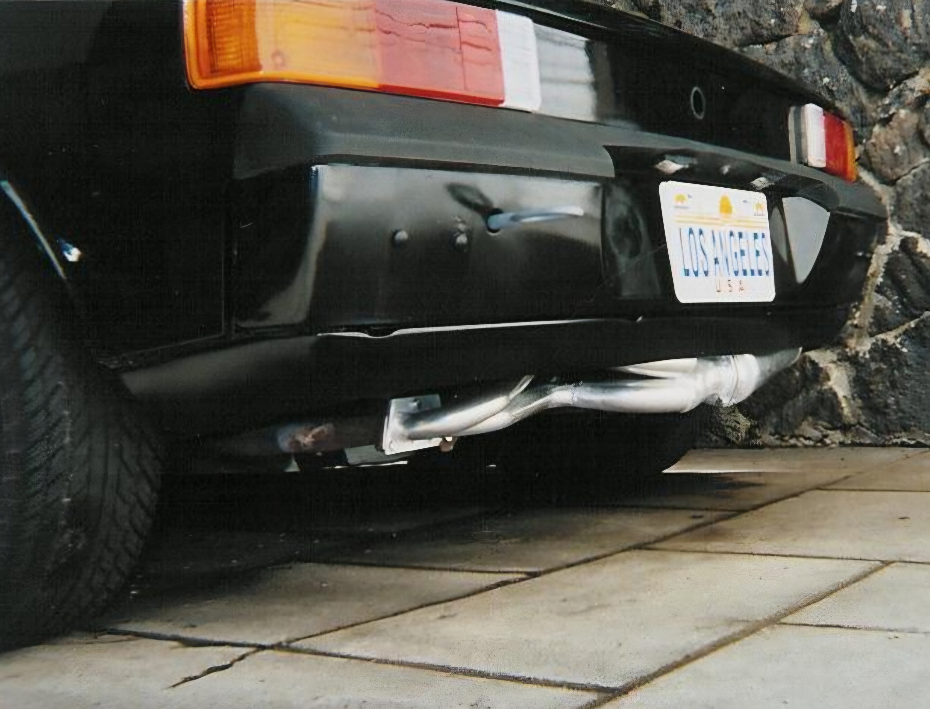

Bought my teener with three exhaust systems. Previous owner installed stainless heat exchangers (thank you) and installed a stock replacement muffler that is in poor condition.
Included in the sale is a single Bursh exhaust and quad Ansen style. Which one has a better exhaust note and the advantages of each. Help me decide. Thanks!Attached Image I

Keep and restore the Bursch, it's a decent design.
Have your muffler shop add a 2.5" (#f4) flange just after the 4x2x1 merge. Bolt on a 2.25" core magnaflow muffler; then blast and ceramic coat everything. You get a great working/sounding system, not heavy and run a custom (R exit) style valance/ or no valance
