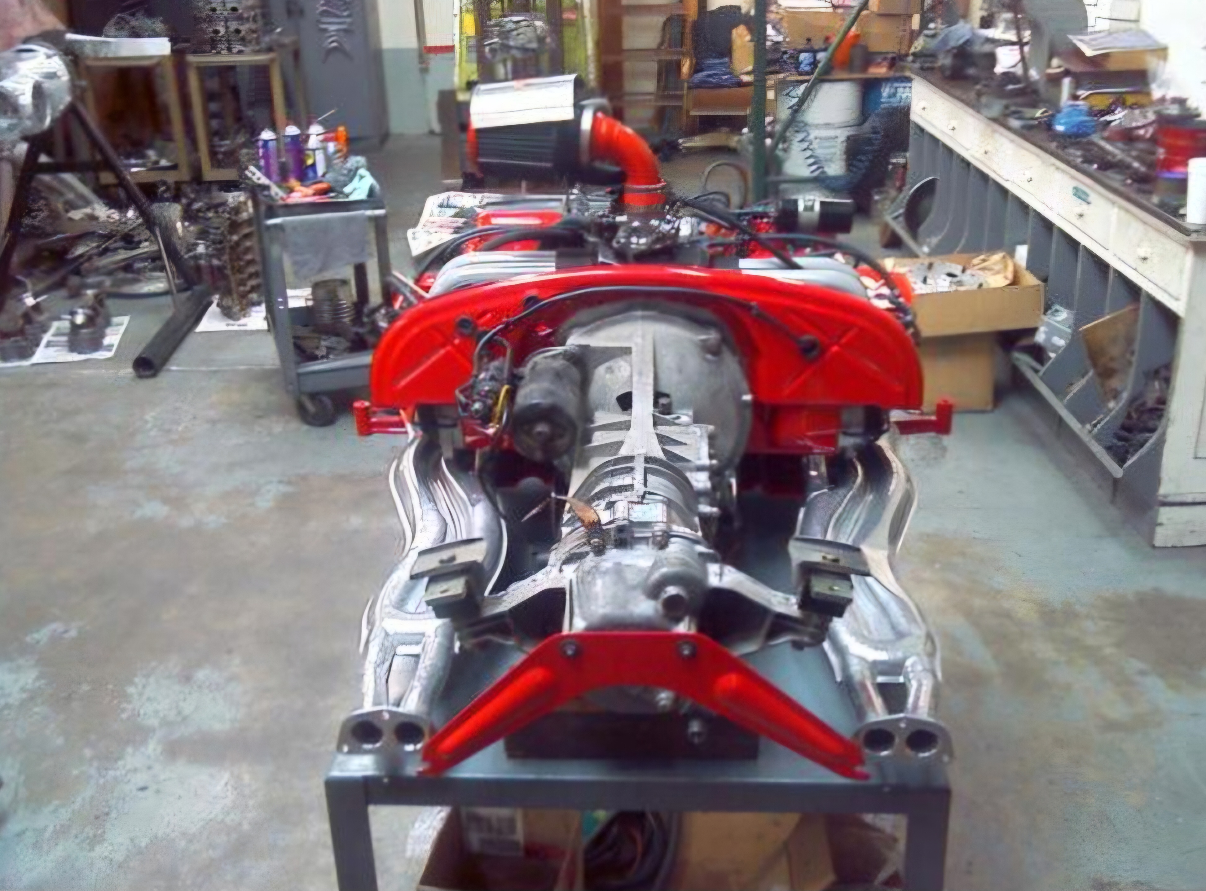

We also had the OE h/b's opened up (inside tube dia.) for more flow 'Extrude Hone process; then ceramic coated with the Bursch/ Magnaflow combo. Shut the engine off after 20 min POC session...it's cool to the touch in 15 min.

Maltese Falcon   Keep and restore the Bursch, it's a decent des...   May 30 2024, 06:25 PM
Maltese Falcon   If you are handy with a hole saw/ Dremel you can r...   May 30 2024, 06:28 PM

Maltese Falcon   We also had the OE h/b's opened up (inside tub...   May 30 2024, 06:48 PM

Literati914   .. Have your muffler shop add a 2.5" (#f4) f...   May 31 2024, 08:57 AM
Maltese Falcon   @Literati914 Yes, entire inside dia of entire len...   May 31 2024, 11:27 AM
