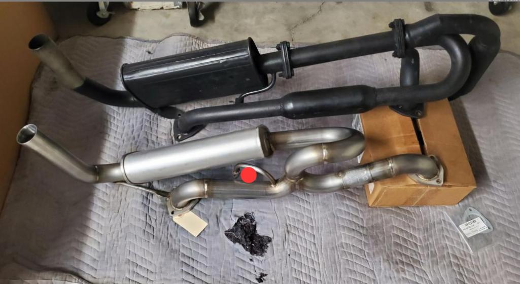

Bought my teener with three exhaust systems. Previous owner installed stainless heat exchangers (thank you) and installed a stock replacement muffler that is in poor condition.
Included in the sale is a single Bursh exhaust and quad Ansen style. Which one has a better exhaust note and the advantages of each. Help me decide. Thanks!Attached Image I

@drem914 have your local welding guy attach a small piece of ⅛ x 1" flatbar inbetween the egr tube and main 2" section of Bursch extractor; thank me later when you don't need to R+R (IMG:style_emoticons/default/biggrin.gif)

Artfrombama   Which exhaust would you choose?   May 29 2024, 11:58 PM
ndfrigi   Bursch muffler. That manza 4 tip is heavy.   May 30 2024, 02:30 AM
Tonyooc   Bursh is the way to go.   May 30 2024, 03:47 AM
mate914   Bursh sounds sooo much better and is also less wei...   May 30 2024, 04:32 AM
mepstein   :agree: but I would plan for something better in ...   May 30 2024, 05:15 AM
TX914   I would go with the Bursch. You can make it look n...   May 30 2024, 08:05 AM
Cairo94507   I would install the single-tip all day long. :be...   May 30 2024, 08:10 AM
brant   4 into 2 into 1   May 30 2024, 08:13 AM
technicalninja   I'd go Bursch for the facts mentioned above AN...   May 30 2024, 08:15 AM
TX914   Sound... https://www.youtube.com/watch?v=FdrpPvhzW...   May 30 2024, 08:39 AM
rjames   No brainer. The Ansa / Monza style is heavy, obnox...   May 30 2024, 09:54 AM
mepstein   No brainer. The Ansa / Monza style is heavy, obno...   May 30 2024, 10:21 AM
dr914@autoatlanta.com   yes certainly the bursch, but my preference these ...   May 30 2024, 11:03 AM
drem914   Definitely the Bursch! picture of what a new ...   May 30 2024, 11:56 AM
TX914   Definitely the Bursch! picture of what a new...   May 31 2024, 08:25 AM
drem914   Definitely the Bursch! picture of what a ne...   May 31 2024, 11:48 AM
edesparza704   Definitely the Bursch! picture of what a new...   Aug 27 2024, 12:26 PM
BillJ   I had one one my yellow 73 because the tips went w...   May 30 2024, 12:02 PM
windforfun   I put a new Dansk on my 1.7. Single pipe like the...   May 30 2024, 03:44 PM
wonkipop   @Artfrombama if you are handy with a welder i ha...   May 30 2024, 04:11 PM
wonkipop   here is what i am talking about @Artfrombama ...   May 30 2024, 04:25 PM
Maltese Falcon   Keep and restore the Bursch, it's a decent des...   May 30 2024, 06:25 PM
Maltese Falcon   If you are handy with a hole saw/ Dremel you can r...   May 30 2024, 06:28 PM
windforfun   Nice impostor license plate. You're busted. ...   May 30 2024, 06:32 PM
Maltese Falcon   Nice impostor license plate. You're busted. ...   May 30 2024, 06:50 PM
Maltese Falcon   We also had the OE h/b's opened up (inside tub...   May 30 2024, 06:48 PM
Maltese Falcon   @MATTYLITE cooking off some hot Type4 laps at the...   May 30 2024, 06:53 PM
Literati914   .. Have your muffler shop add a 2.5" (#f4) f...   May 31 2024, 08:57 AM
Maltese Falcon   @Literati914 Yes, entire inside dia of entire len...   May 31 2024, 11:27 AM
Artfrombama   Excellent response to this thread, great informati...   May 31 2024, 11:39 AM
Maltese Falcon   @drem914 have your local welding guy attach a sma...   May 31 2024, 02:11 PM
drem914   @Maltese Falcon Sorry, but what is the tube even f...   Jun 6 2024, 04:11 PM
Maltese Falcon   @drem914 does in fact look like an EGR tube, and ...   Jun 6 2024, 04:34 PM
Ishley   I have a '72 that came with a Bursch... I...   Aug 27 2024, 02:35 PM
