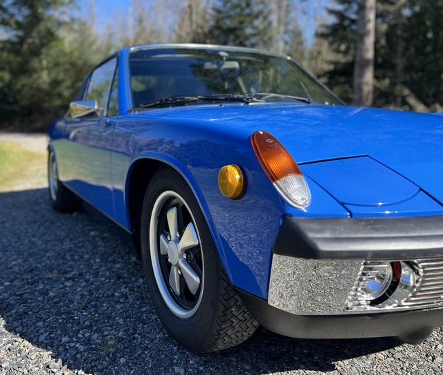

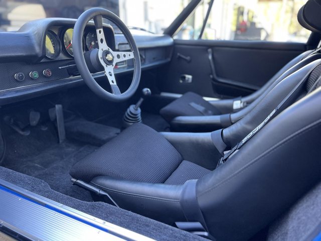

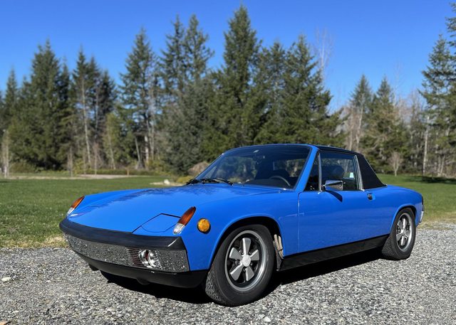

A few more tweaks now that I am past the break in.
Swapped in the JWest Rennline shifter. Combined with the Tangerine Racing shift rod kit, it eliminated the 901 “stirring oatmeal” shift feel and I’m in love with how crisp the shifter is.
(IMG:http://www.914world.com/bbs2/uploads_offsite/i.imgur.com-21443-1719374162.1.jpg)
Upgraded the master to a 23mm and it firmed up the pedal perfectly.
The GT style fuel gauge isn’t accurate. Stumbled on a nice trio guage and will upgrade that along with a euro Speedo.
The engine pulls hard but at about 5500rpm it feels a tad lean. Bernie is going to play with jetting to see if we can richen it up at top.
(IMG:http://www.914world.com/bbs2/uploads_offsite/i.imgur.com-21443-1719374162.2.jpg)
(IMG:http://www.914world.com/bbs2/uploads_offsite/i.imgur.com-21443-1719374162.3.jpg)
