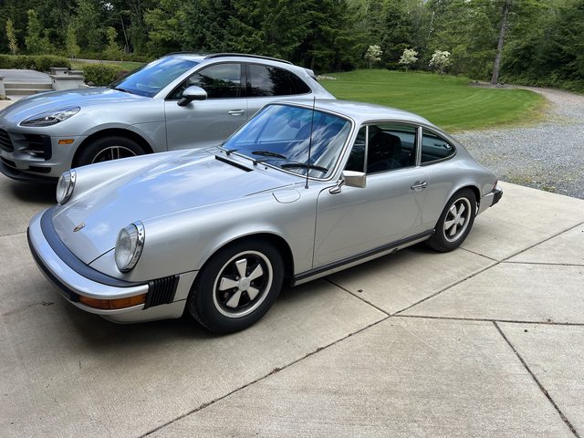

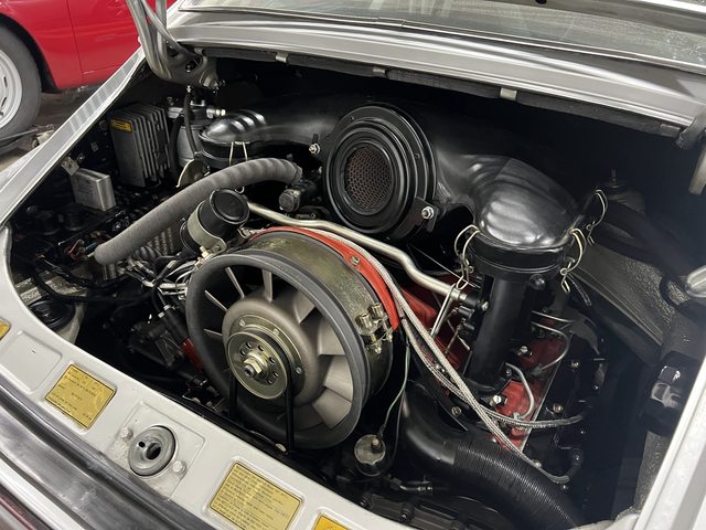

For fun, also showing its stablemate that is now complete. The RS 2.7 MFI is wonderful to compare to the twin plug 2.7. It utterly transforms the 911s and I’m in love with the torque and instant hot of the MFI.
