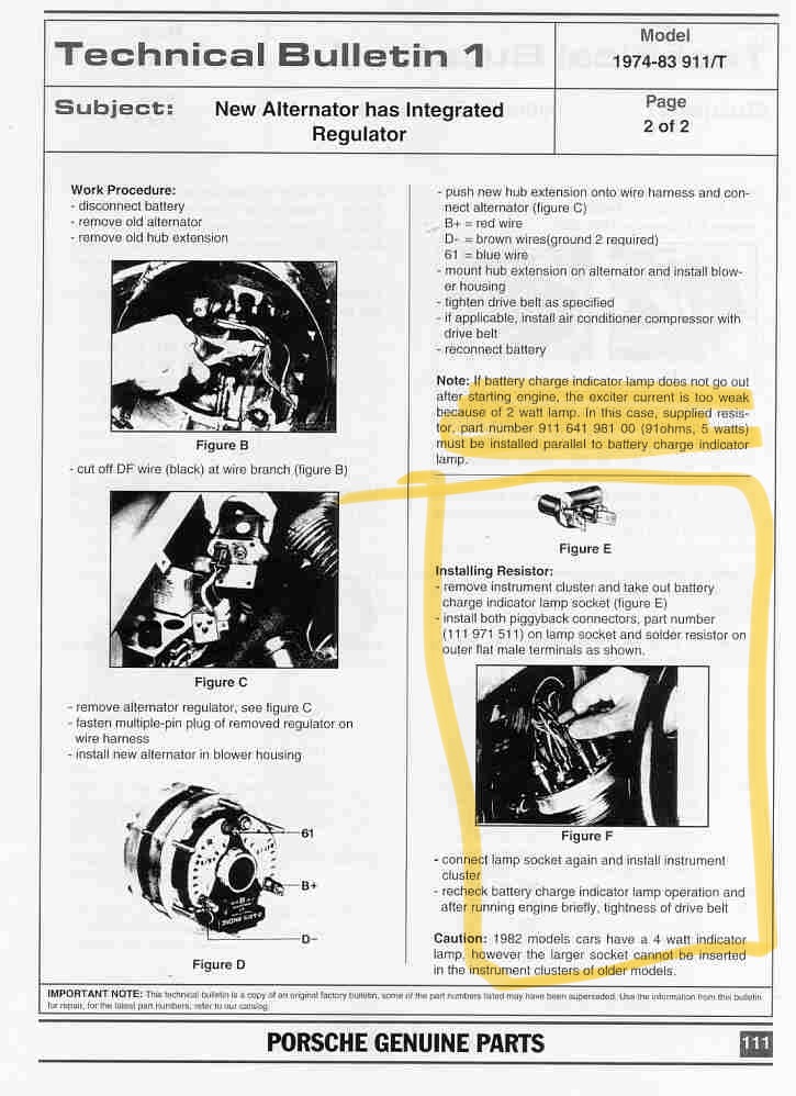

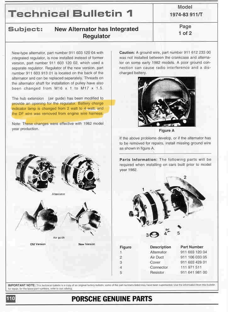

Can’t help you if you choose not to troubleshoot the blue D+ wire. That wire should have a ground on it at start up and then goes to 12v once the alternator has been excited.
With respect to a bulb change. Seems crazy but if that charge lamp bulb doesn’t flow enough current - there is no excitation. See Porsche bulletin below
Attached ImageAttached Image

Can’t help you if you don’t chase the blue D+ wire. That wire should have a ground on it at start up and then goes to 12v once the alternator has been excited.
How do you find this stuff?? I look and look and you guys find it. Thanks
maybe the bulb wattage is not allowing the alternator to get excited? sounds crazy, but leave it to those Germans (IMG:style_emoticons/default/idea.gif)

QUOTE(930cabman @ Jul 15 2024, 03:00 PM) *
I highly doubt that. You could certainly try a higher wattage bulb (4W); won’t hurt anything.
As it stands right now you have 12v at key on on the red/white wire side of the bulb.
You state the current charge lamp bulb lights when tested separately so the bulb is OK
What is missing is a ground path on the blue wire when the engine is not running. You’ve said you checked blue wire and it has no path to ground, nor does it have 12v on the blue wire when running. Therefore, something isn’t right in the blue wire D+ (61) circuit.
The problem isn’t the bulb wattage at this point.
