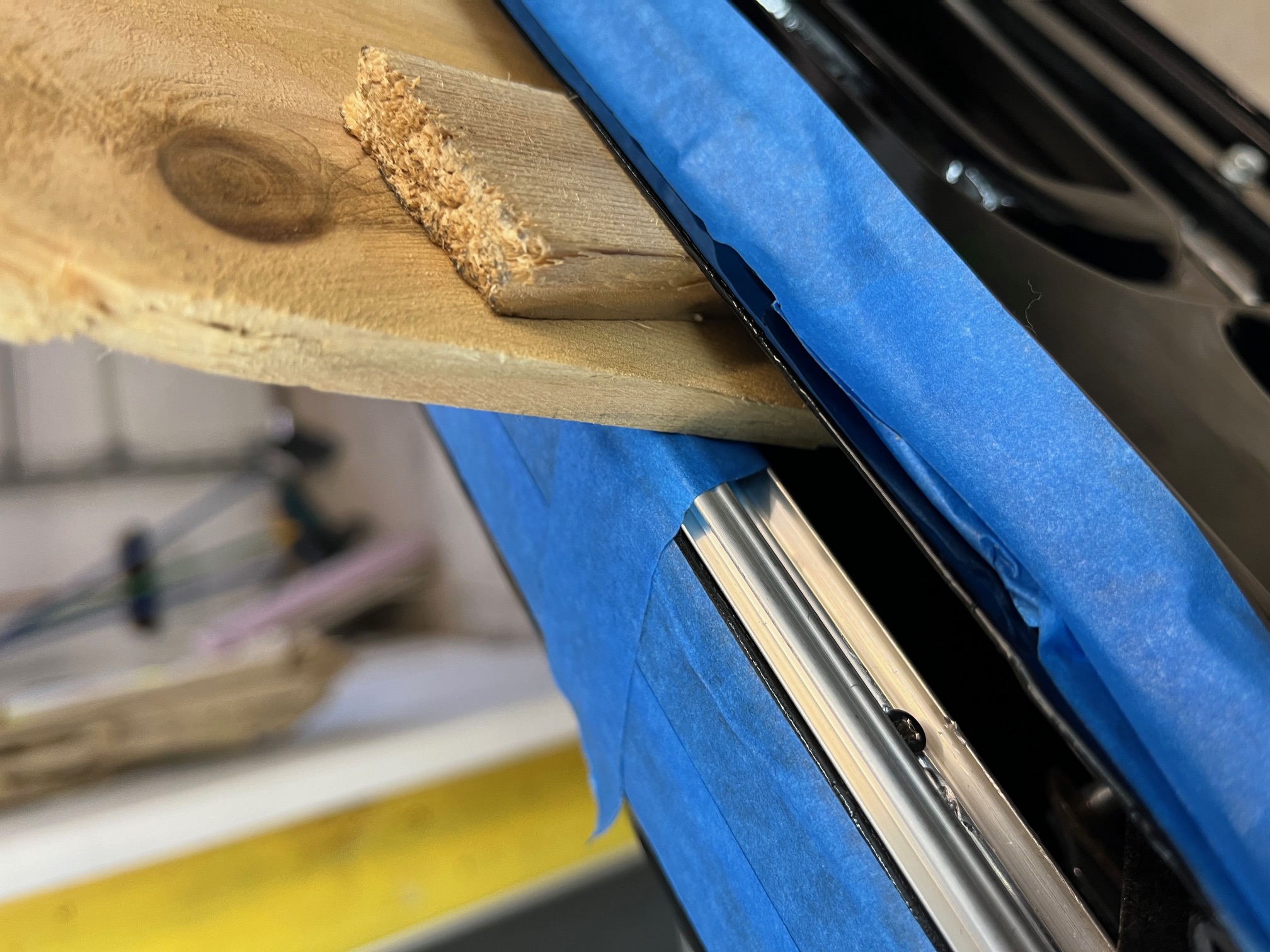

Window roller replacingAttached Image
Don't use a sledge hammer like some of the youtube videos suggest get the proper puller. Attached Image

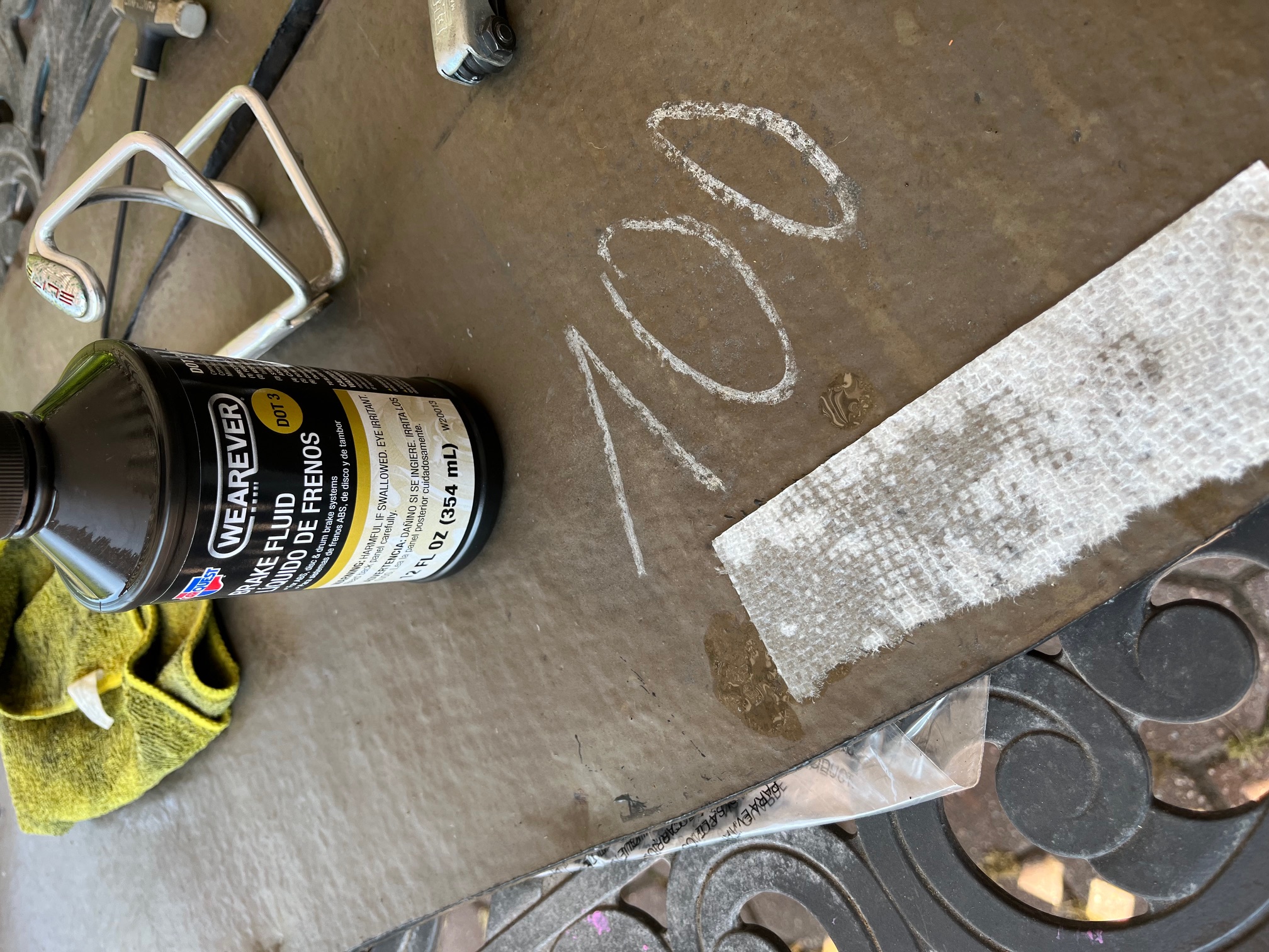

Original Engine pad refurbishing and paint removal use brake fluid it does not hurt rubber but removes paint. use a paper towel soaked in fluid for tough spots. Attached Image Attached ImageAttached Image
