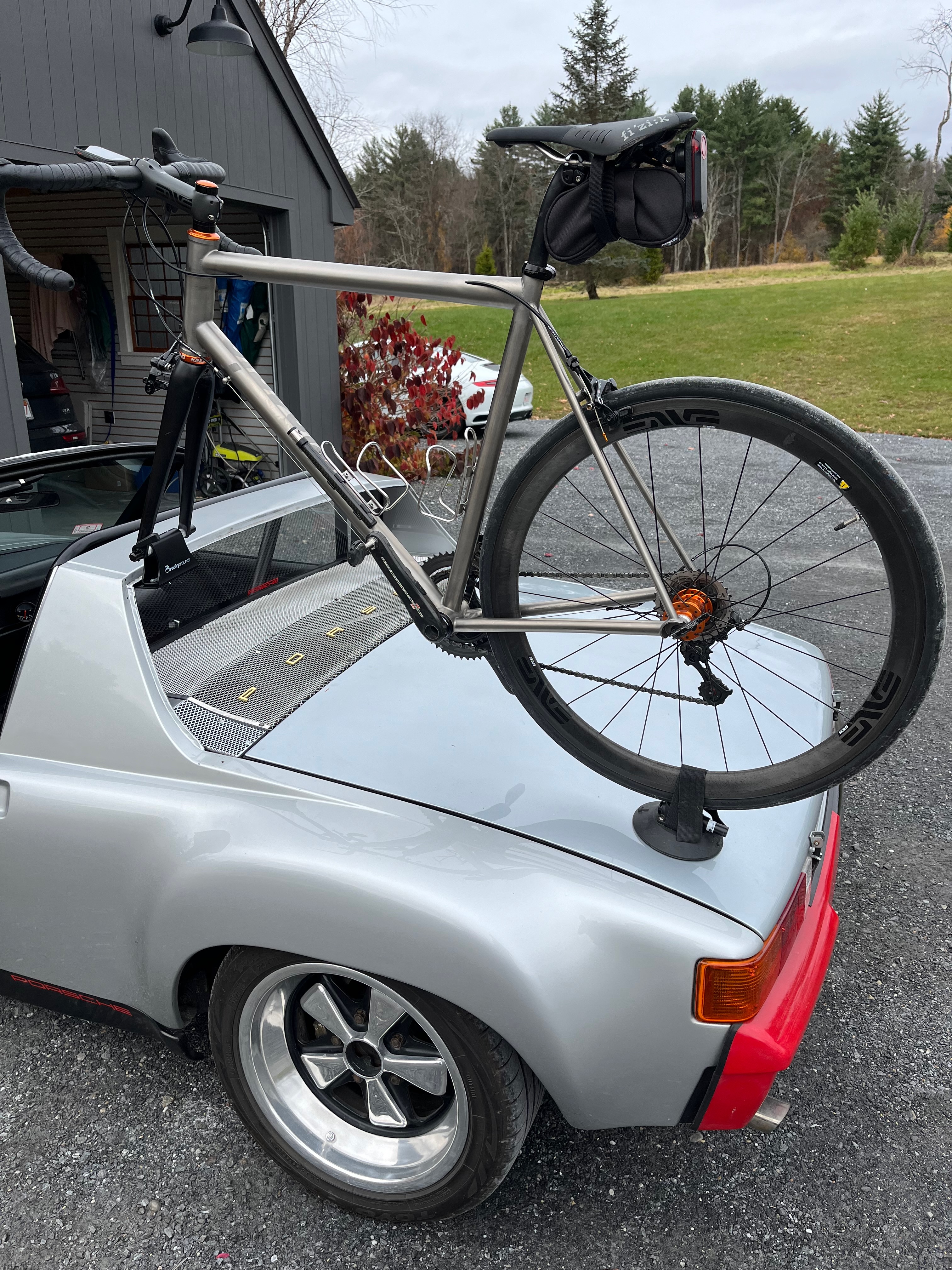

morehills
post Oct 29 2024, 03:31 PM
Posts: 152
Joined: 2-March 23
From: Great Barrington, MA
Member No.: 27,202
Full set up with Sea Sucker rear mount
