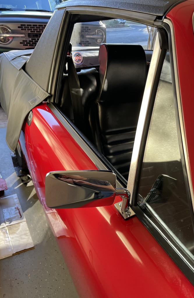

Have you noticed how your stock side mirrors do not sit horizontal? Here is a photo of my right side mirror, taken with the camera set horizontal and the mirror straight out from the door. Notice how the mirror center tilts downward to the outside.
The fix is a 4° wedge-shaped gasket that replaces the stock gasket. My son will 3D print these on demand from TPU, with 95A hardness, so they are somewhat flexible and enough squish to conform to the slight curve at the top of the door. The price is $15 per pair, shipped to anywhere in the US. You can order them through this PayPal listing:

Thanks for the motivation on this. Just added a passenger side mirror. Wow! It will never have to droop!
