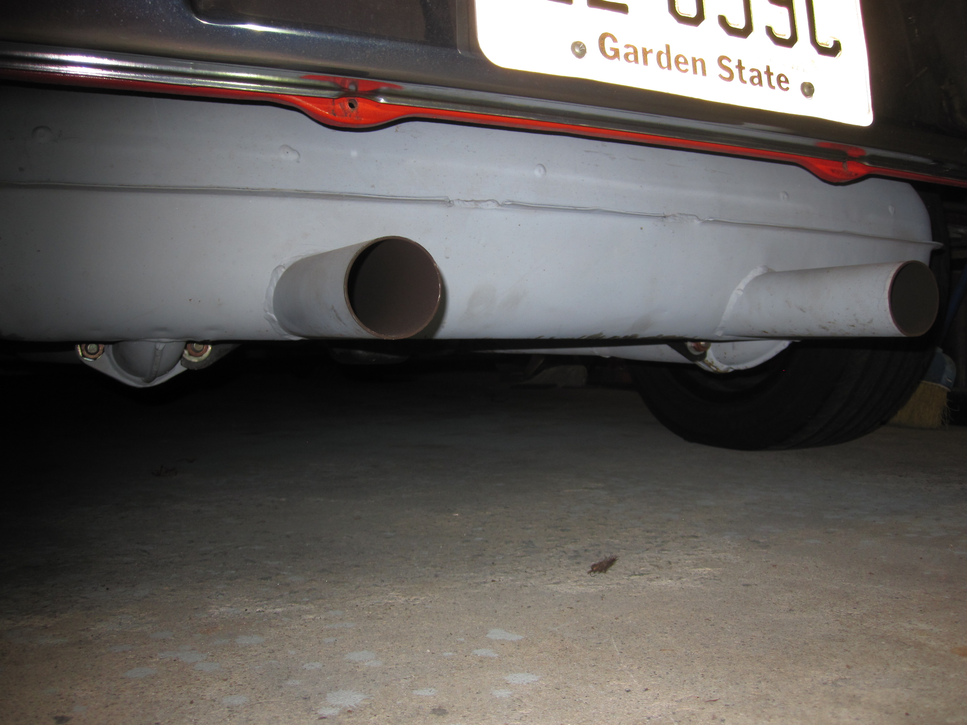

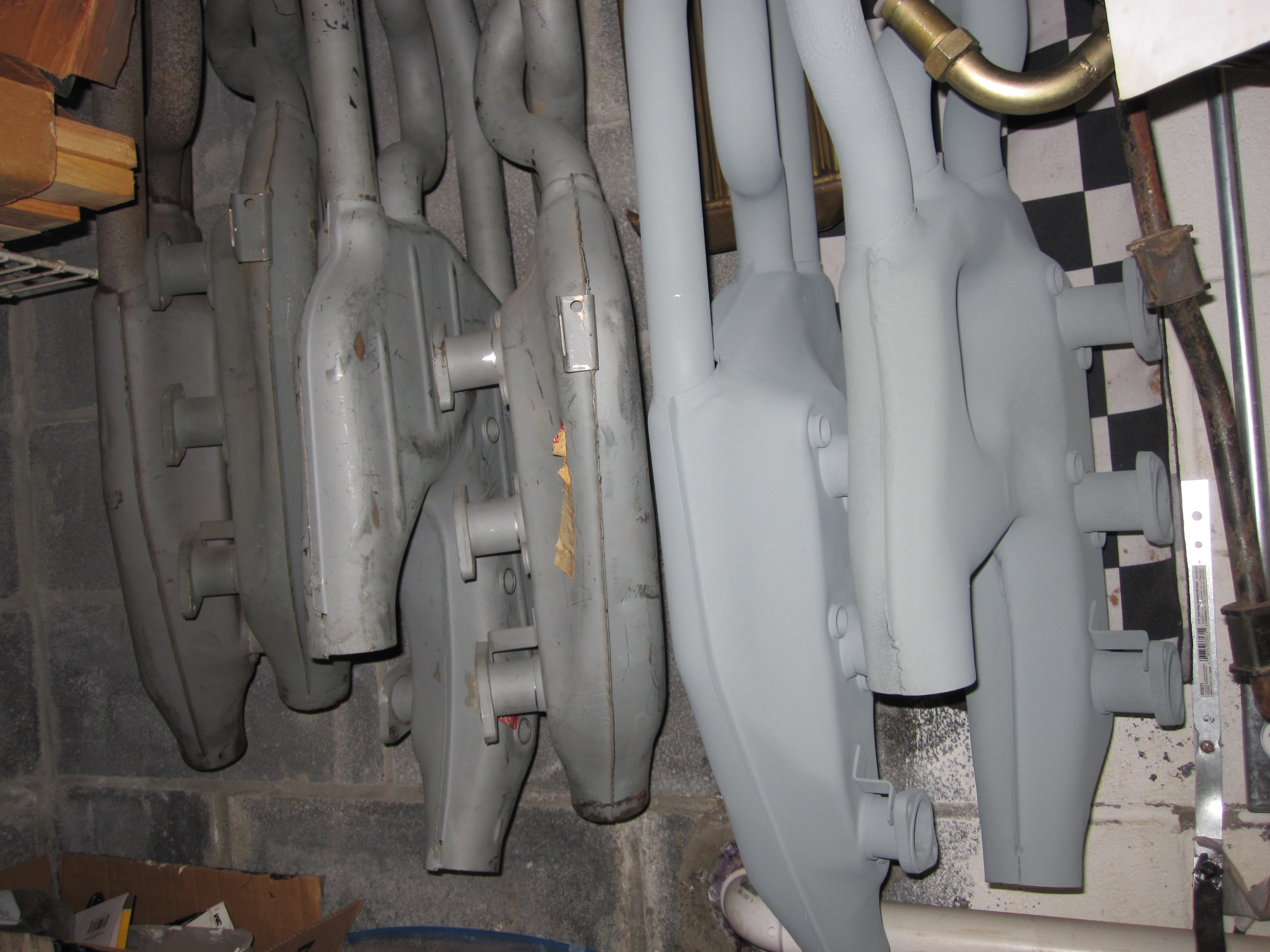

The one on the car was shot early summer and has seen many miles and a Drivers
Ed a Lime Rock. VHT 2000F primer
The ones hanging on the right were just done with Rustoleum Cold Galvanising
grey. Not run yet.
All the others hanging are original NOS paint. Don't get too hung up on the shade.
Just about any flat grey will do. Go for long lasting if don't want to do it again.
