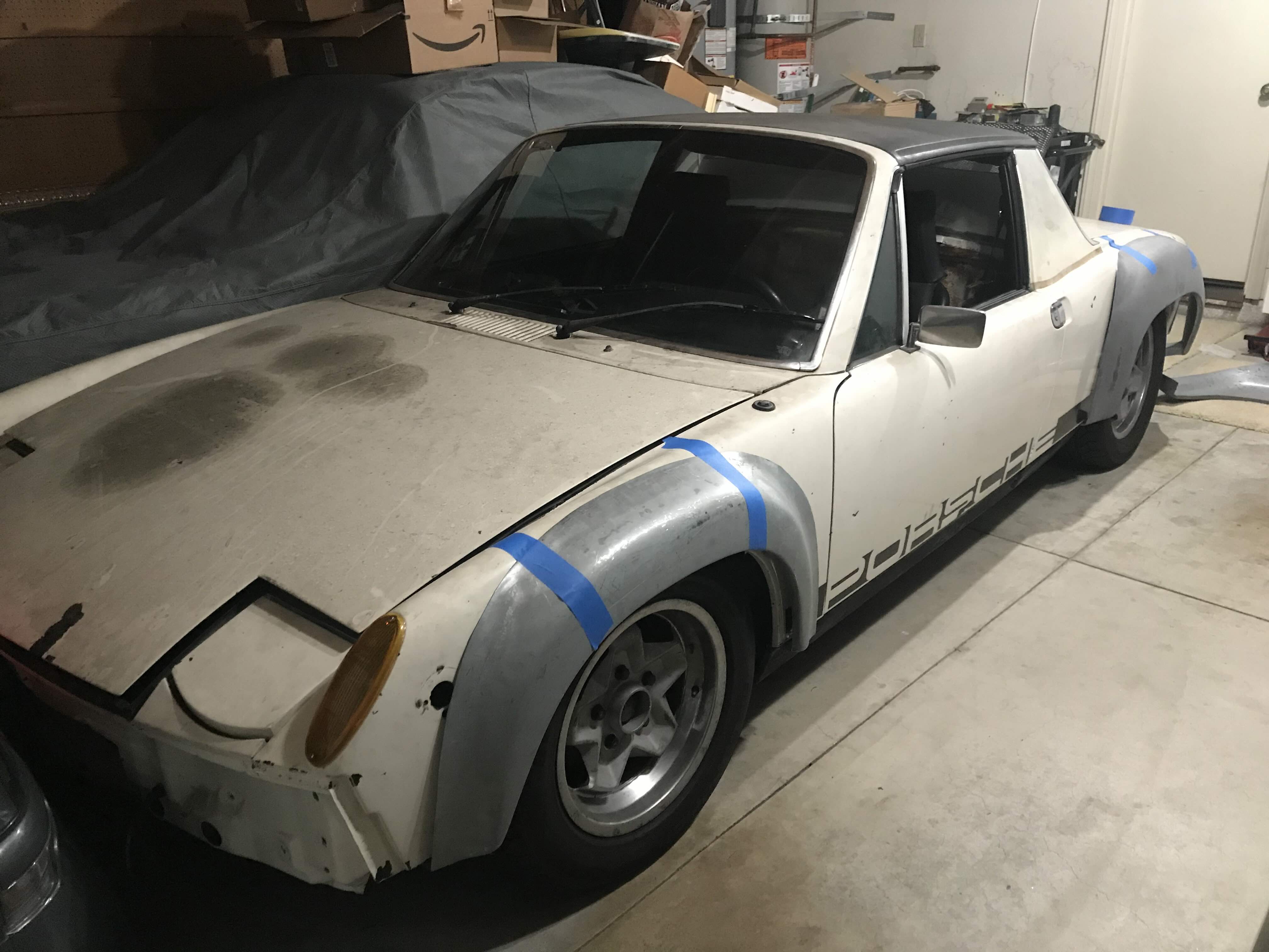

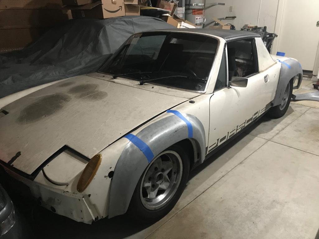

Nana's_914   Could you guys suggest a good body shop in SoCal I...   Jun 23 2026, 11:55 AM
DennisV   Could you guys suggest a good body shop in SoCal ...   Jun 23 2026, 02:24 PM
seanpaulmc   Could you guys suggest a good body shop in SoCal...   Jun 23 2026, 05:11 PM
seanpaulmc   There is also en MacFarland who travels to do fla...   Jun 23 2026, 05:17 PM
Nana's_914   [quote name='Nana's_914' post='3262489' date=...   Jun 23 2026, 06:04 PM
mb911   [quote name='Nana's_914' post='3262489' date...   Jun 24 2026, 10:46 AM
