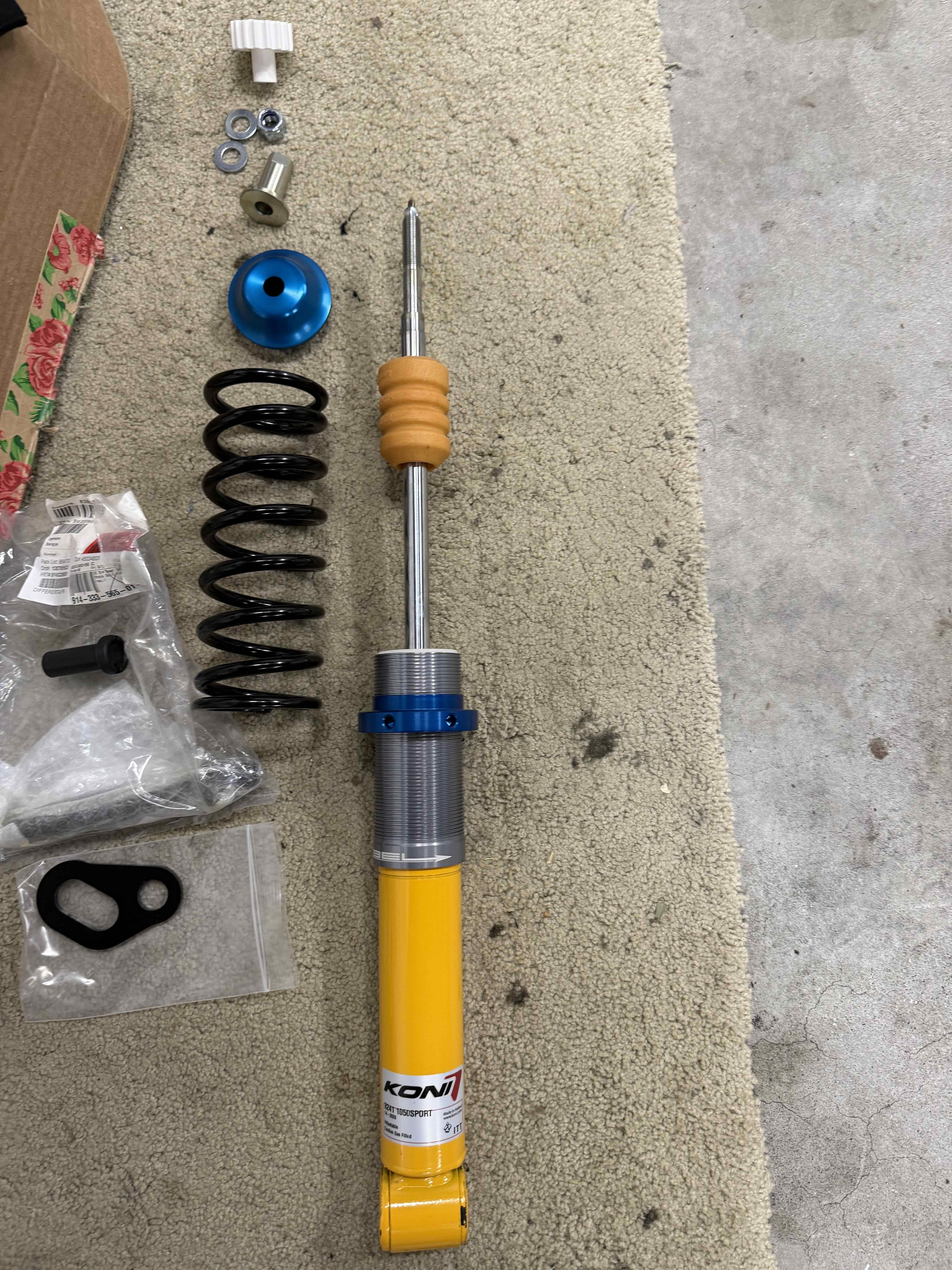

Working on installing rear Koni Yellows with a Rebel Racing coil over kit and 180# springs. I'm using this thread for reference:
http://www.914world.com/bbs2/index.php?sho...8779&st=20#

Nana's_914   Working on installing rear Koni Yellows with a Reb...   Jun 30 2026, 06:01 PM
Nana's_914   Assembled coilovers.   Jul 2 2026, 11:05 AM
Nana's_914   Installed. Have a few issues though. Both traili...   Jul 2 2026, 11:17 AM
