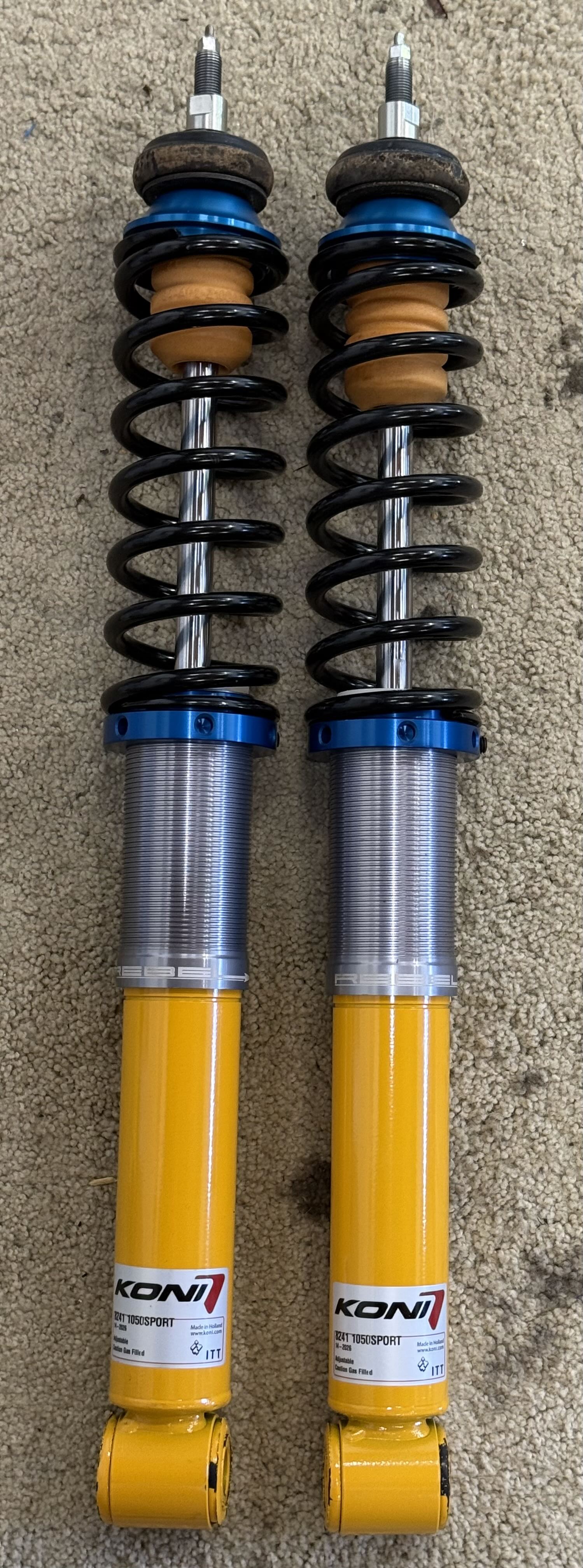

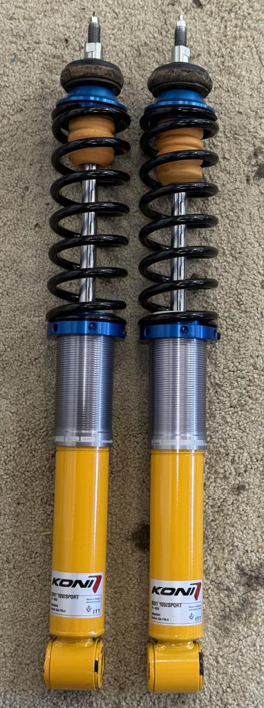

Nana's_914   Working on installing rear Koni Yellows with a Reb...   Jun 30 2026, 06:01 PM
Nana's_914   Assembled coilovers.   Jul 2 2026, 11:05 AM
Nana's_914   Installed. Have a few issues though. Both traili...   Jul 2 2026, 11:17 AM
Nana's_914   Installed. Have a few issues though. Both trail...   Jul 24 2026, 11:50 AM
