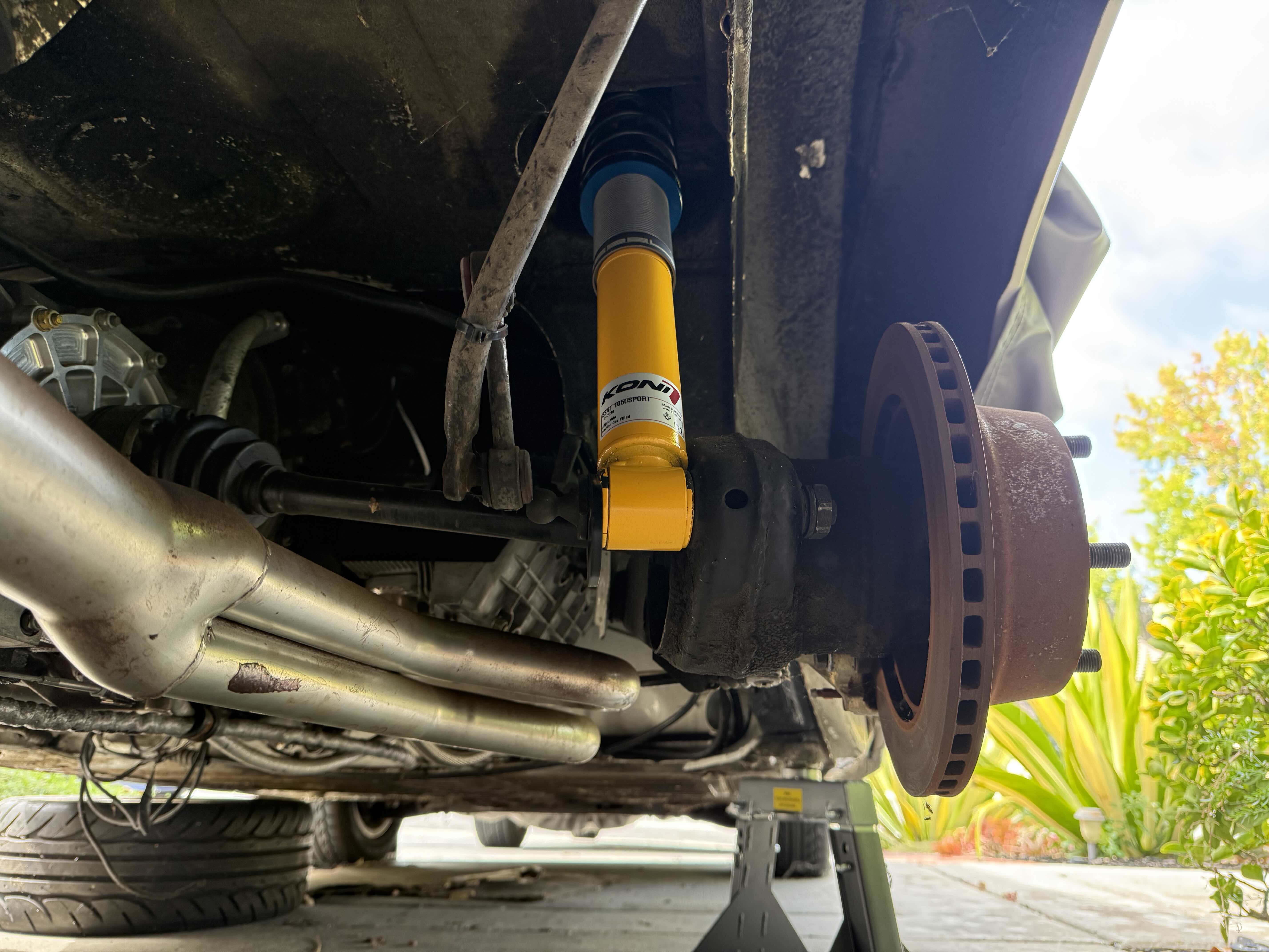

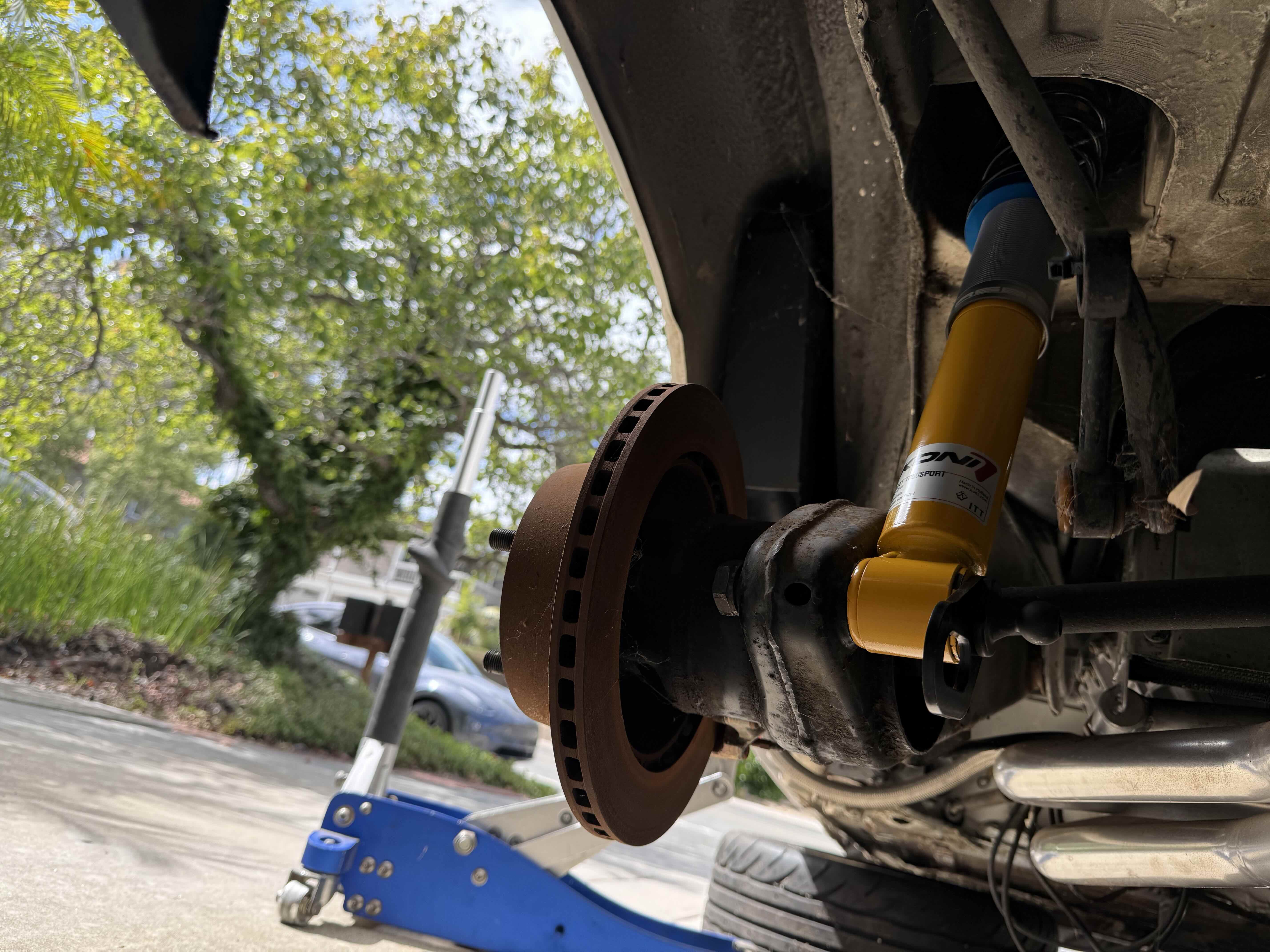

Nana's_914   Working on installing rear Koni Yellows with a Reb...   Jun 30 2026, 06:01 PM
Nana's_914   Assembled coilovers.   Jul 2 2026, 11:05 AM

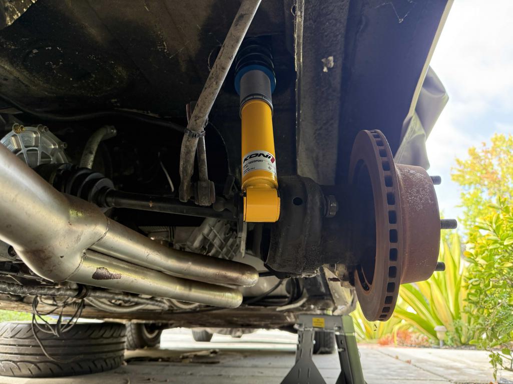

Nana's_914   Installed. Have a few issues though. Both traili...   Jul 2 2026, 11:17 AM
Nana's_914   Installed. Have a few issues though. Both trail...   Jul 24 2026, 11:50 AM

Cfletch   Installed. Have a few issues though. Both trai...   Jul 24 2026, 01:36 PM
Nana's_914   Does anyone have any tips for proper routing of ...   Jul 24 2026, 03:14 PM
Luke M   [quote name='Cfletch' post='3266186' date='Jul 24...   Jul 25 2026, 01:32 PM
Cfletch   If you DM me your cell number I can send some pics...   Jul 24 2026, 03:18 PM
Nana's_914   If you DM me your cell number I can send some pic...   Jul 24 2026, 03:37 PM
