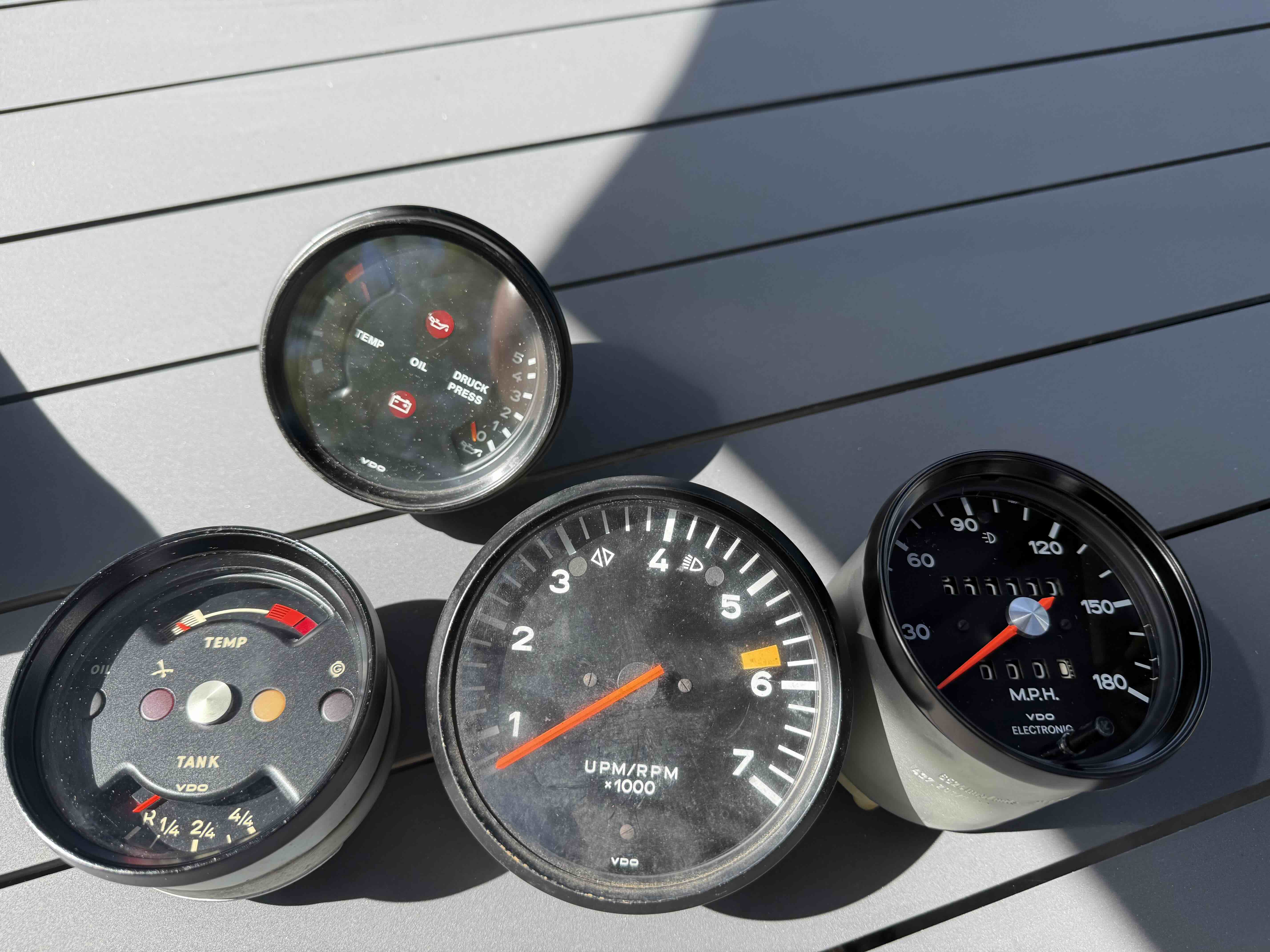

I've been working through my gauge options. I have an electronic speedo and a 914-6 combo gauge ready to go, so the tach is the last piece to sort out.

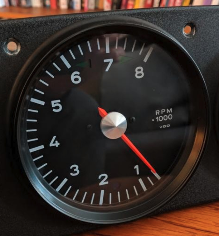

I was thinking about having North Hollywood or Palo Alto rebuild my stock tach to work with the DME and add the silver button to match my other gauges. The one thing holding me back is the odd single-light turn signal indicator. The other option is to track down an early tach core and build something with both arrows and the silver button dial.
This is the look I'm after — silver button center, both turn signal arrows and rotated numbers.
I also have an '85 911 oil pressure/temp gauge that could serve as a core for a triple gauge.
