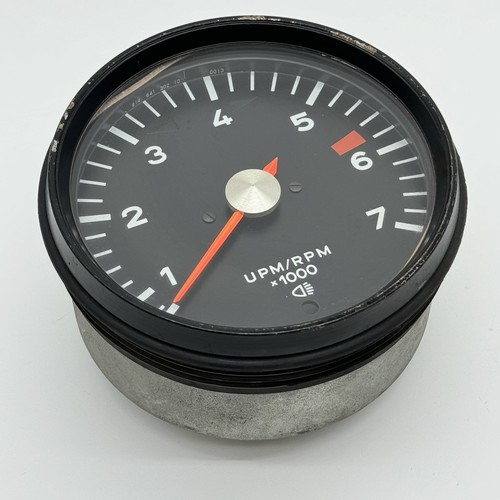

Nana's_914
post Jul 24 2026, 11:50 AM
Posts: 129
Joined: 27-October 06
From: San Diego, CA
Member No.: 7,100
Found a tach core.

Nana's_914   Found a tach core.   Jul 24 2026, 11:50 AM
