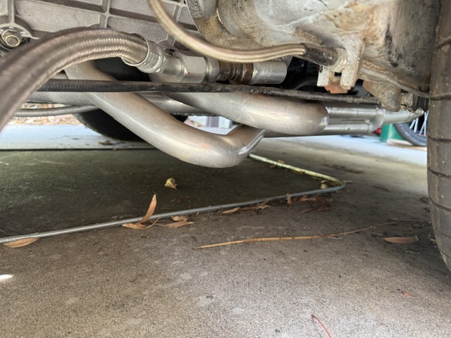

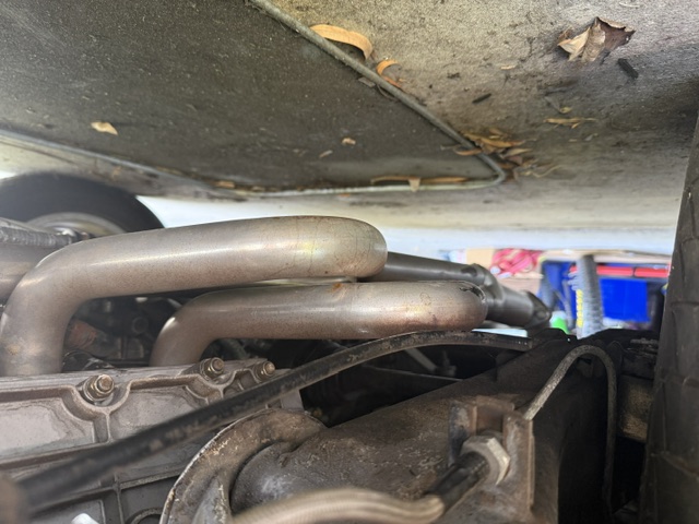

Installed. Have a few issues though. Both trailing arms are not articulating well, significant binding. The left side also has an interference issue with the parking brake cable running into the header on droop.
Does anyone have any tips for proper routing of the parking brake cable to keep it from getting burnt on the header?
I assume you are meaning specifically for the passenger side cable? Mine runs the length of the bulkhead, then hooks over to the spot in the trailing arm. Its safe and out of the way of the header there. I do have it ziptied in one spot at the 4 cylinder engine mount area to just keep it tidy

QUOTE(Cfletch @ Jul 24 2026, 03:36 PM) *
QUOTE(Nana's_914 @ Jul 24 2026, 10:50 AM) *
Hits on both sides. It looks like both cables need an anchor near the pivot of the control arm to hold them up off the headers. Looks like the oil line to the oil cooler needs to redone too.
