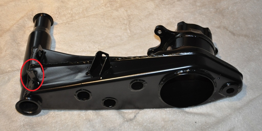

Hits on both sides. It looks like both cables need an anchor near the pivot of the control arm to hold them up off the headers. Looks like the oil line to the oil cooler needs to redone too.

Does anyone have any tips for proper routing of the parking brake cable to keep it from getting burnt on the header?
I assume you are meaning specifically for the passenger side cable? Mine runs the length of the bulkhead, then hooks over to the spot in the trailing arm. Its safe and out of the way of the header there. I do have it ziptied in one spot at the 4 cylinder engine mount area to just keep it tidy
Does your control arm have this bracket on it?
My 6 used a strap to hold it away from the headers.
I thought I had pics of it but I can't find it.
