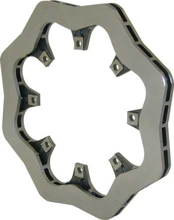

I placed an order with Wilwood today for a pair of their 12.19" diameter vented rotors along with the aluminum mounting hats.....
The factory 911 rotors are one piece, with the rotor and the hat cast as one piece.
The reason I went with the 12 inch rotor was to make it easier to bolt on the 4-pot rx-7 calipers....another 914 owner here welded on new caliper brackets, but I didn't want to go that route (I might weld new brackets for the trailing arm, but I didn't want to play around too much with the front struts)
I'm hoping these new rotors will fit a 911 strut and allow the same rx-7 calipers to be used.....

QUOTE (TimT @ Feb 17 2005, 05:11 PM)
its no biggie, but you will need a spacer. I have 944T discs on my 911, and a spacer is required to clear the a-arm. Those wilwood discs are larger OD than the 944T so...
thanks for heads up.... (IMG:http://www.914world.com/bbs2/html/emoticons/beerchug.gif)
I "almost" sprung for the drilled rotors since they are just a few bucks more, but I chickened out (IMG:http://www.914world.com/bbs2/html/emoticons/smile.gif)
have you known anyone to run the "scalloped" rotors??

TimT   Mike you will have to make some spacers, and space...   Feb 17 2005, 05:48 PM

TimT   its no biggie, but you will need a spacer. I have ...   Feb 17 2005, 06:11 PM

Jeroen   Tim, what's the deal with the 944turbo rotors ...   Feb 18 2005, 05:58 AM
TimT   Jeroen, I have this brake set up on my 911. With ...   Feb 18 2005, 07:06 AM
