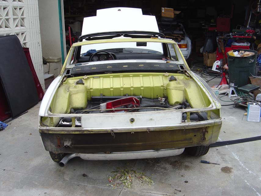

A naked rear!!!

skline   A naked rear!!!   Mar 8 2005, 02:04 PM
