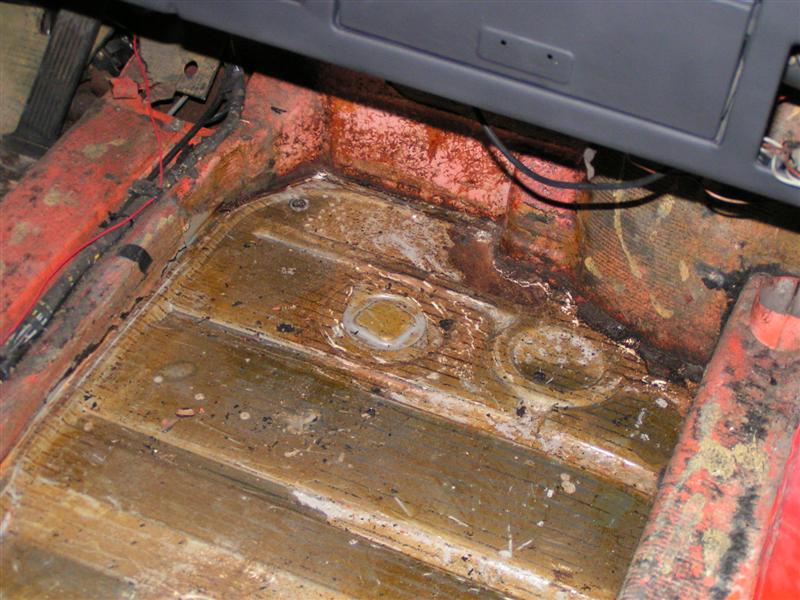

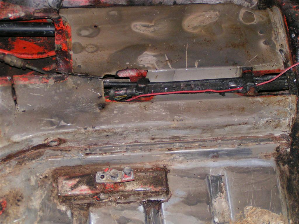

ok, I did the passenger side floor pan today after I got off work, before sundown(need more lights in the garage), removed all the tar(about 2 1/2 hours, a heat gun and a putty knife)
there is some funky "glue" looking stuff under the tar paper... what gets this off? aircraft paint stripper did nothing to it...
there is a little rust along the horizontal support... where the tar met the weld... the area is very small, and doesn't extend "up" onto the cross piece... how should I fix this? I'm thinking of rust killer, and then weld in a little angle-piece for extra support... is this ok, or do I need to cut all of this and weld in a new piece ?
here are a few pics, there are more in the BLOG, please give me your opinions...

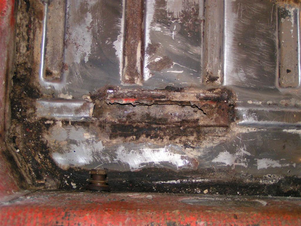

ok picture time:
does brake cleaner work? damn straight it does!
BEFORE:

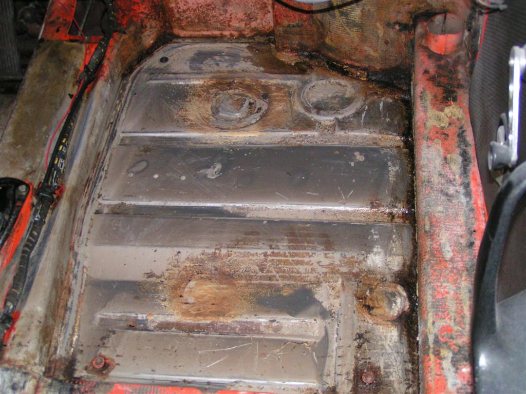

(IMG:http://www.914world.com/bbs2/uploads/blog-1115347808.jpg)
AFTER:
(IMG:http://www.914world.com/bbs2/uploads/blog-1116120374.jpg)
how much of the sealer that is still there do I need to get up?
a better pic of where the rusted out hinge was... I plan to cut part of the pan out here too and weld in a new piece of sheet metal...

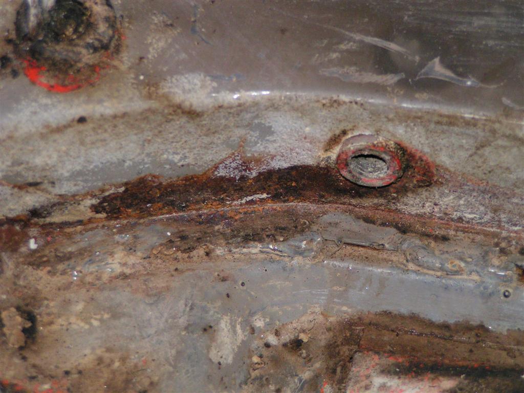

last pic: a little surface rust where the seat belt attachment was all the rust I found today... I'll treat this and it is still solid...
(IMG:http://www.914world.com/bbs2/uploads/blog-1116120428.jpg)
