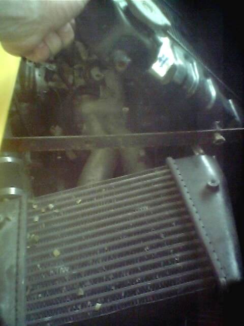

banksyinoz   i also have a wrx powered 914 it runs a wolf ems (...   Jun 17 2005, 05:56 PM
neo914-6   banksyinoz, why not just post them here? <...   Jun 17 2005, 07:08 PM
redshift     Jun 17 2005, 07:13 PM
Mueller
  Jun 17 2005, 07:41 PM
neo914-6   ...   Jun 17 2005, 07:51 PM
airsix   <...   Jun 17 2005, 11:19 PM
banksyinoz   the pics r crappy but its only a phonecamera the c...   Jun 17 2005, 11:31 PM
banksyinoz   i believe that if anyone can build something in th...   Jun 17 2005, 11:38 PM
banksyinoz   the computer that was used was a "wolf " it runs e...   Jun 17 2005, 11:45 PM
