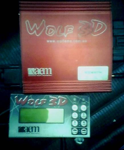

the computer that was used was a "wolf " it runs everything apart from the auto however the program has all the trims plus 5 extra aux outputs combined with the handset it is one of the better ones available here in oz i am not sure if it can b plugged straight in yet but can be wired up easily
