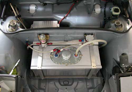

E-Man   Sorry it took so long and the poor quality of pict...   Jul 6 2005, 09:44 PM
E-Man   Sorry it took so long and the poor quality of pict...   Jul 6 2005, 09:45 PM
