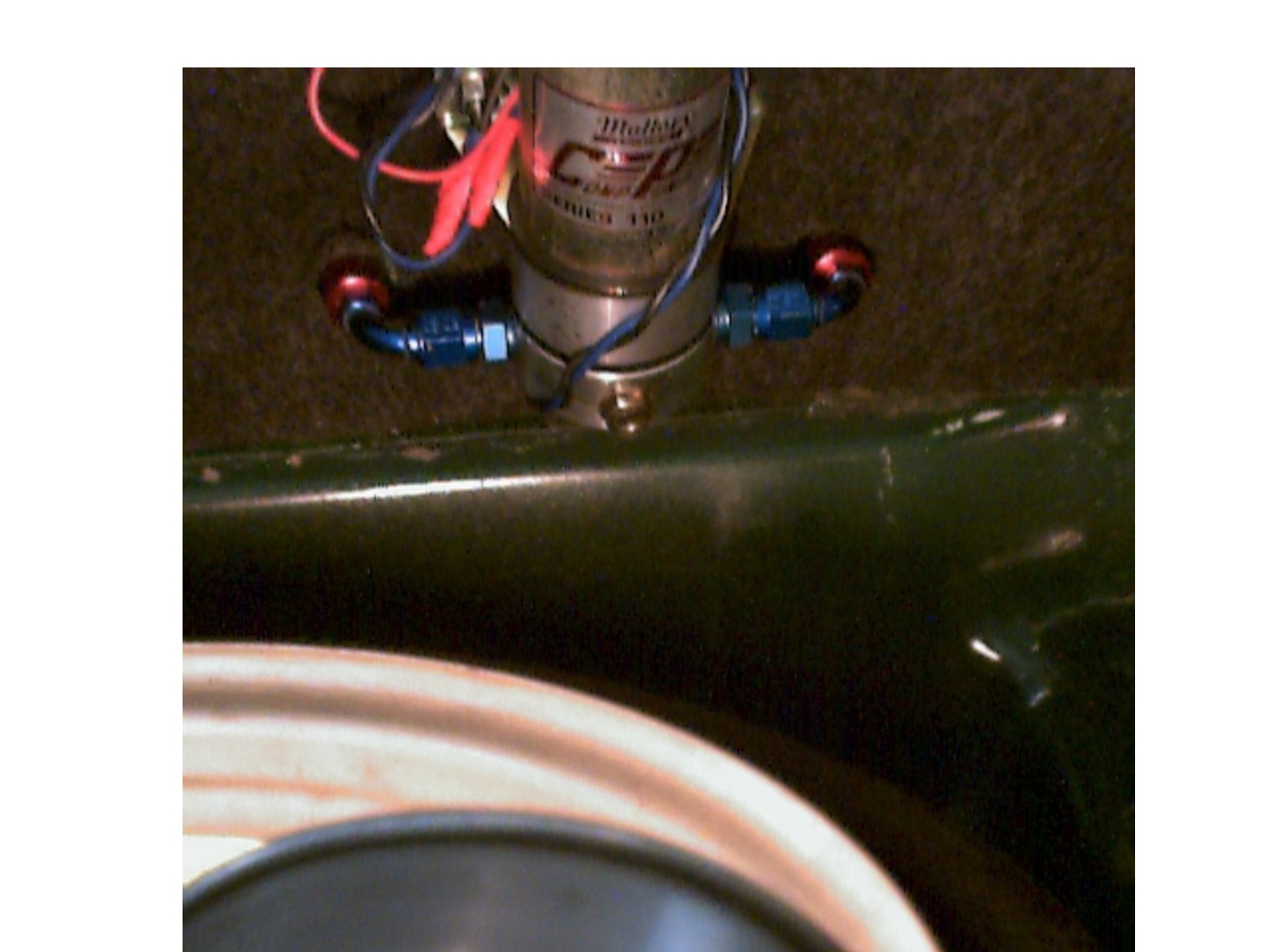

Mallory makes an electric pump for both carbs and fuel injection all models have a 3/8 NPT inlet/outlet.
For fuel injection, they recommend a filter before the pump and a filter before the injectors.
What I am not too sure about is how to plumb it all, from what I can find, it looks like it'll have to be all -6 AN fittings.
Now to figure out what brand fittings and hose (IMG:http://www.914world.com/bbs2/html/emoticons/wacko.gif)

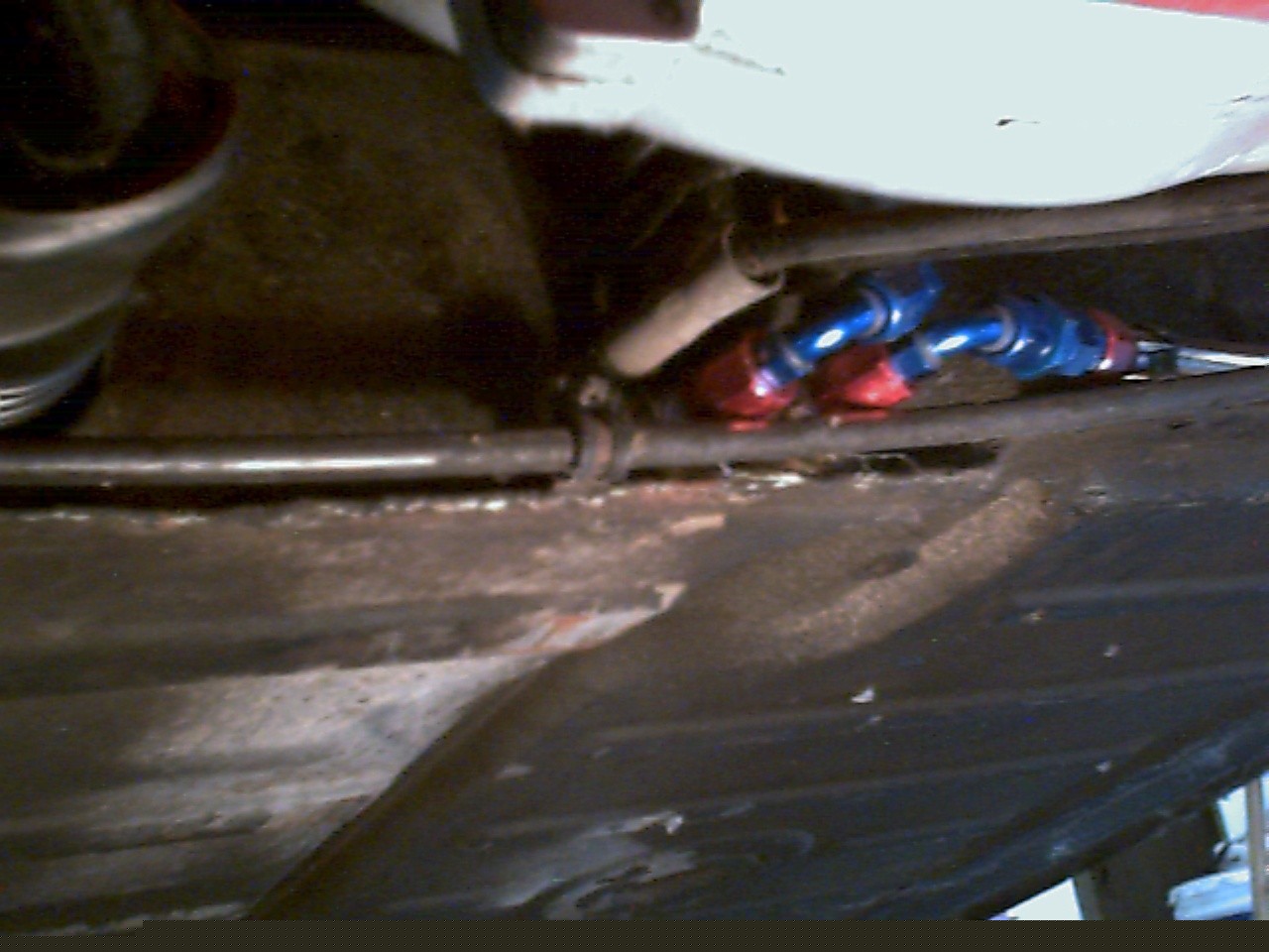

Sorry it took so long and the poor quality of pictures (crap camera). -Mike

E-Man   Hose clamp works fine there, even with FI since th...   Jun 21 2005, 11:03 AM
synthesisdv   I used the 3/8 =>-6 fittings to save space. the m...   Jun 21 2005, 11:08 AM
