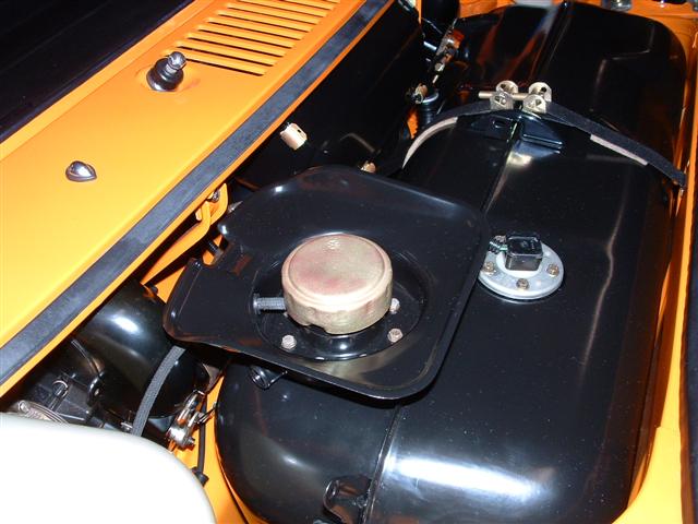

Doug Leggins   The gas tank is installed. I think that I'm r...   Sep 21 2005, 05:07 PM
Doug Leggins   I painted the gas cap with Eastwood's cad pain...   Sep 21 2005, 05:10 PM
