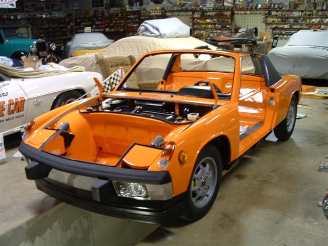

Doug Leggins   Progress today. I was able to make good progress ...   Sep 14 2005, 11:41 PM
Doug Leggins   Had my hardware gathered and ready.   Sep 14 2005, 11:42 PM
Doug Leggins   bumper bones and hardware   Sep 14 2005, 11:44 PM
Doug Leggins   I got a good deal on a 73/74 front bumper months a...   Sep 14 2005, 11:49 PM
Doug Leggins   I have several hours of polishing in each of the f...   Sep 14 2005, 11:56 PM
Doug Leggins   Monday I picked up the fiberglass portion of the f...   Sep 15 2005, 12:00 AM
Doug Leggins   Still need to adjust the fog lights and add a coup...   Sep 15 2005, 12:02 AM
Doug Leggins   last pic today, hopefully more tomorrow.   Sep 15 2005, 12:03 AM

Doug Leggins   Need to get the front hood installed. Tomorrow is...   Sep 15 2005, 11:35 PM

Doug Leggins   Started retrofitting my engine to a 914 set up. ...   Sep 29 2005, 08:16 PM
SpecialK   hmmmm.......looks like you need some new heat-shri...   Sep 29 2005, 08:21 PM
Engman   Jeeezzz, stop already! You are making my car ...   Sep 29 2005, 08:27 PM
SpecialK     Sep 29 2005, 08:33 PM
Doug Leggins   Here's what it looks like now. I am planning...   Sep 29 2005, 08:37 PM
