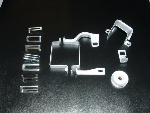

Pretty brackets (IMG:http://www.914world.com/bbs2/html/emoticons/laugh.gif) (IMG:http://www.914world.com/bbs2/html/emoticons/laugh.gif) (IMG:http://www.914world.com/bbs2/html/emoticons/laugh.gif)
Likely not to be seen much ever again, so posting them for all to see. (IMG:http://www.914world.com/bbs2/html/emoticons/wink.gif)
