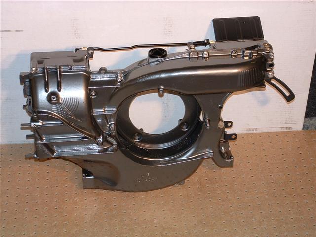

Doug Leggins   I've been getting parts ready for installing t...   Sep 27 2005, 06:45 PM
Doug Leggins   A lot of the steps move along slow because it is t...   Sep 27 2005, 06:48 PM
Doug Leggins   Mostly alternator pieces. I had no idea that there...   Sep 27 2005, 06:50 PM
Doug Leggins   Pretty brackets http://www.914w...   Sep 27 2005, 06:53 PM
Doug Leggins   Some assembly work completed   Sep 27 2005, 07:06 PM
Doug Leggins   I used SS fasteners to attach the blower housing h...   Sep 27 2005, 07:10 PM
Doug Leggins   A little more assembly that I completed last night...   Sep 27 2005, 07:12 PM
