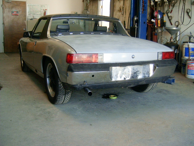

Has any one out there tried to mount older metal bumpers on later rubber bumper cars we are doing a 914 6 project on a rust free late car that had the late stlye bumpers any thoughts or help? Randy

whaletailcanada   bumpers on 75/76 cars   Sep 29 2005, 02:35 PM
Headrage   Yep, just did mine. Old   Sep 29 2005, 02:42 PM
Headrage   New   Sep 29 2005, 02:43 PM
Dave_Darling   Show him the tabs you had to cut off. There's...   Sep 29 2005, 05:22 PM
MW 914   ...   Sep 29 2005, 05:26 PM
Headrage   And this channel needs to be cut back.   Sep 29 2005, 05:26 PM
Headrage   Same on the rear.   Sep 29 2005, 05:27 PM
MW 914   I just drilled the spot welds enough to pop them o...   Sep 29 2005, 05:27 PM
Headrage   Then ya gotta plug these hole so water doesn't...   Sep 29 2005, 05:31 PM
sixnotfour   FYI; If you go with fiberglass bumpers the front ...   Sep 29 2005, 05:57 PM
