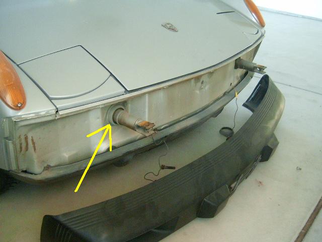

Has any one out there tried to mount older metal bumpers on later rubber bumper cars we are doing a 914 6 project on a rust free late car that had the late stlye bumpers any thoughts or help? Randy

Then ya gotta plug these hole so water doesn't get in the trunk. I'm going to use the shock retainers as a template and make some plugs in case somebody down the road wants to go back to original.

Headrage   Yep, just did mine. Old   Sep 29 2005, 02:42 PM
Headrage   New   Sep 29 2005, 02:43 PM
Dave_Darling   Show him the tabs you had to cut off. There's...   Sep 29 2005, 05:22 PM
MW 914   ...   Sep 29 2005, 05:26 PM
Headrage   And this channel needs to be cut back.   Sep 29 2005, 05:26 PM
Headrage   Same on the rear.   Sep 29 2005, 05:27 PM
MW 914   I just drilled the spot welds enough to pop them o...   Sep 29 2005, 05:27 PM
Headrage   Then ya gotta plug these hole so water doesn't...   Sep 29 2005, 05:31 PM
sixnotfour   FYI; If you go with fiberglass bumpers the front ...   Sep 29 2005, 05:57 PM
