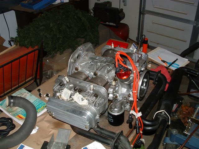

Doug Leggins   Started retrofitting my engine to a 914 set up. ...   Sep 29 2005, 08:16 PM
SpecialK   hmmmm.......looks like you need some new heat-shri...   Sep 29 2005, 08:21 PM
