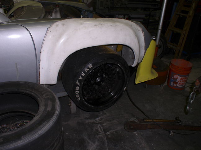

Well, it has front suspension now! (IMG:http://www.914world.com/bbs2/html/emoticons/monkeydance.gif)
The spindles were re-bored to get a little more camber, dropped one inch on the tubes and gusseted. The A-arms are seam welded and reinforced in the sway bar link area.
The curreent set-up is Koni yellows, Weltmeister bushings, and 23mm torsion bars, though it will probably get coilovers before it hits the track. Eventually the stock A-arms will be replaced by 935 type ball jointed arms.
Here's a pic of the strut tube before paint.

Mugs914   Here's the whole thing in place. Got to make s...   Nov 5 2005, 12:41 AM
Mugs914   Here's another that shows the dropped spindle ...   Nov 5 2005, 12:46 AM
J P Stein   Are you going to joggle the steering arm or use th...   Nov 5 2005, 12:49 AM
