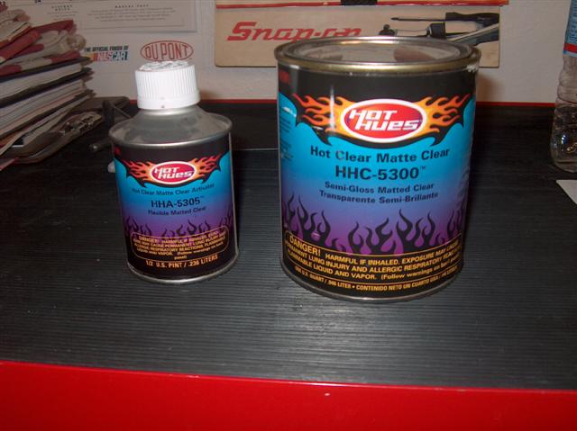

Thomas J Bliznik Posted on Dec 17 2005, 08:30 PM
Lou,
Be sure to use Clear Satin. You don't want it shiny. The clear fills in the porous Body Schutz surface. That's why the dirt & grime wash off easy. It also keeps the dark color fresh a long time.
Tom
Thanks Tom, This is what my paint supplier recomended, they said alot of the Hot Rod guys use this;
