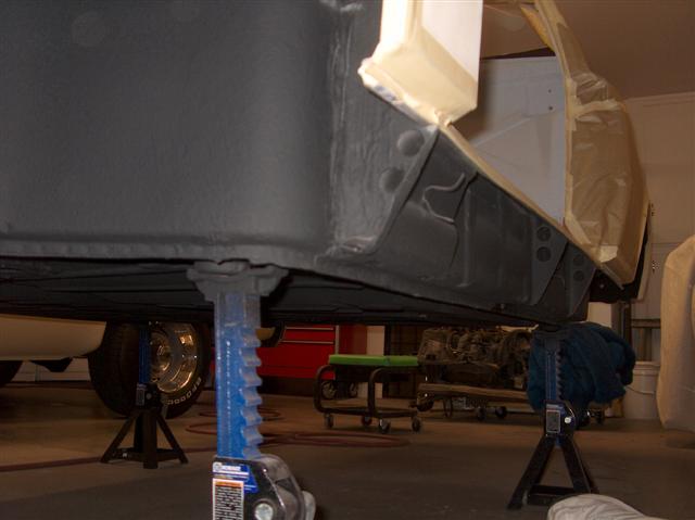

I got the rest of the underside cleaned up and shot with the Body Shutz;

JB 914   Looking good Lou! How did you strip the botto...   Dec 16 2005, 11:06 PM
Lou W   I sprayed Castrol Super Clean (Purple Container) f...   Dec 17 2005, 12:07 AM
