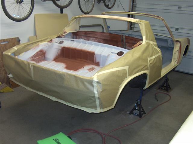

Now I'm masking the topside so I can shoot the clear;

Lou W   Now I'm masking the topside so I can shoot the...   Dec 30 2005, 10:21 PM
