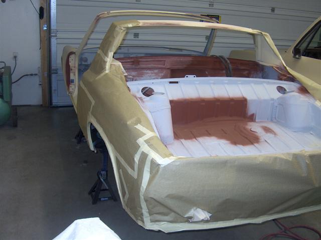

Lou W   Now I'm masking the topside so I can shoot the...   Dec 30 2005, 10:21 PM
Lou W   again;   Dec 30 2005, 10:22 PM
Lou W   Last one for now; http://www.914wor...   Dec 30 2005, 10:23 PM

Lou W   I bought a new masking machine, it sure makes the ...   Jan 12 2006, 09:28 PM
Lou W   After painting the clear with my old Binks spray g...   Jan 12 2006, 09:30 PM
Lou W   This is the primer that I used;   Jan 12 2006, 09:31 PM
Lou W   Here are some shots after the top side was primere...   Jan 12 2006, 09:32 PM
