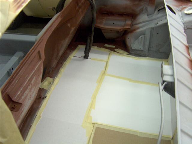

Lou W   Now I'm masking the topside so I can shoot the...   Dec 30 2005, 10:21 PM

Lou W   I shot the clear on the underside last week, it tu...   Jan 12 2006, 09:26 PM
Lou W   another;   Jan 12 2006, 09:27 PM
Lou W   another, I took the spare tire jack mounts out of ...   Jan 12 2006, 09:27 PM
Lou W   I bought a new masking machine, it sure makes the ...   Jan 12 2006, 09:28 PM
Lou W   After painting the clear with my old Binks spray g...   Jan 12 2006, 09:30 PM
