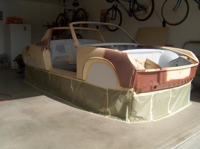

I shot the clear on the underside last week, it turned out a little shinier than what I had hoped , but it still looks good. Im masking the underside in these shots;

Lou W   Now I'm masking the topside so I can shoot the...   Dec 30 2005, 10:21 PM
