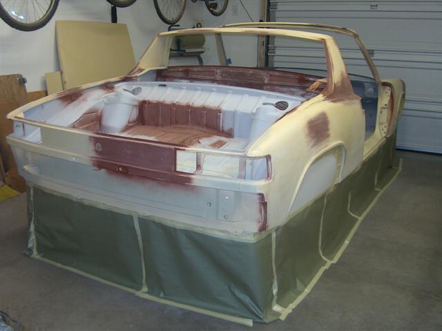

I've been watching Joe O'Brien's progress on the Turtlegirl car, he painted the underside first, before he painted the rest of the body.
The more I thought about doing it that way, the more it made sense, this way I can put the suspension back under it which allow me to roll the car around when I paint the exterior, and it will allow me to make any adjustments to the rear fenders for tire clearance before I put the finish paint on the car.
Here's the car back up in the air, I sure wish I had a rotiserie;

Lou W   I shot the clear on the underside last week, it tu...   Jan 12 2006, 09:26 PM

Lou W   After painting the clear with my old Binks spray g...   Jan 12 2006, 09:30 PM
Lou W   This is the primer that I used;   Jan 12 2006, 09:31 PM
Lou W   Here are some shots after the top side was primere...   Jan 12 2006, 09:32 PM
Lou W   another;   Jan 12 2006, 09:32 PM
Lou W   again;   Jan 12 2006, 09:32 PM
Lou W   Front trunk and Tank area;   Jan 12 2006, 09:33 PM
