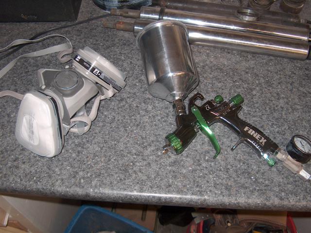

After painting the clear with my old Binks spray gun, and all the overspray to deal with, I decided to buy a new Finex 300 series gun and also a new resperator;

Lou W   After painting the clear with my old Binks spray g...   Jan 12 2006, 09:30 PM
