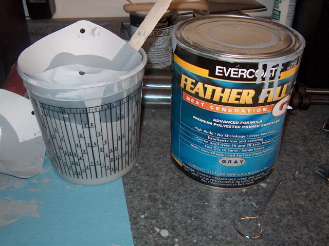

This is the primer that I used;

Lou W   This is the primer that I used;   Jan 12 2006, 09:31 PM
