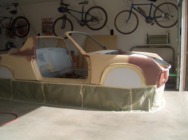

Lou W   I shot the clear on the underside last week, it tu...   Jan 12 2006, 09:26 PM
Lou W   another;   Jan 12 2006, 09:27 PM
Lou W   another, I took the spare tire jack mounts out of ...   Jan 12 2006, 09:27 PM
Lou W   I bought a new masking machine, it sure makes the ...   Jan 12 2006, 09:28 PM
Lou W   After painting the clear with my old Binks spray g...   Jan 12 2006, 09:30 PM

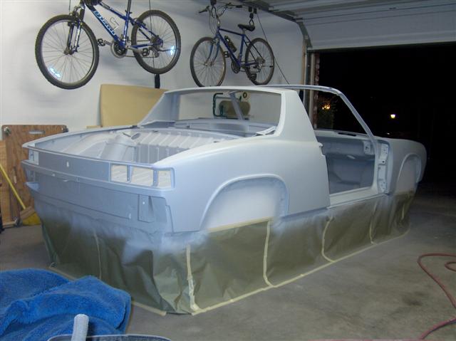

Lou W   Here are some shots after the top side was primere...   Jan 12 2006, 09:32 PM
Lou W   another;   Jan 12 2006, 09:32 PM
Lou W   again;   Jan 12 2006, 09:32 PM

Lou W   Started the final block sanding today, I'm usi...   Jan 16 2006, 07:03 PM
Lou W   Another;   Jan 16 2006, 07:04 PM
Lou W   Driver side rear panel;   Jan 16 2006, 07:04 PM
Lou W   again;   Jan 16 2006, 07:05 PM
Lou W   Nice and smooth;   Jan 16 2006, 07:05 PM
Lou W   Rear trunk;   Jan 16 2006, 07:06 PM
Lou W   Next, I will shoot a couple more thinned down coat...   Jan 16 2006, 07:07 PM
Lou W   Then, I'll finsh with 500 grit, before applyin...   Jan 16 2006, 07:07 PM

Lou W   I shot the final coat of primer last week, so now ...   Jan 23 2006, 12:12 AM
Lou W   Here's a better picture;   Jan 23 2006, 12:13 AM
Lou W   Close up;   Jan 23 2006, 12:13 AM
